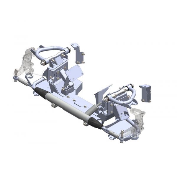

Just thought I'd keep this thread I started up-to-date! I pulled the trigger on the PB Fab version 7, level 3 airbag dropmember kit:
- New crossmember
- Upper & lower control arms
- Rack & pinion steering upgrade
- Small block chevy motor mounts
- New shocks to match the kits mounts
- New transmission crossmember
- Kit is very complete, completely bolt-on, comes with all hardware even all new steering linkage joints and shaft.
They are currently 10-12 weeks out for production which is a little rough, but should give me plenty of time to prepare (procrastinate) the truck for the kit.
I'll post pics when all the bits and pieces arrive!
