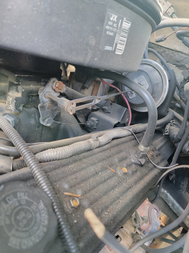

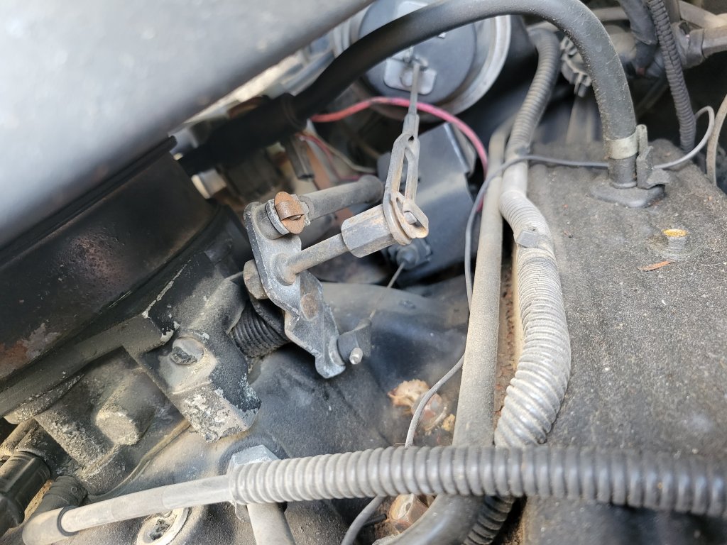

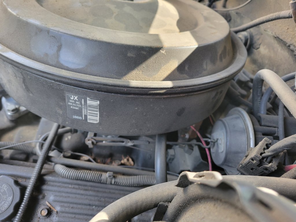

pictures of my 1990 Suburban. I suspect they are nearly identical
