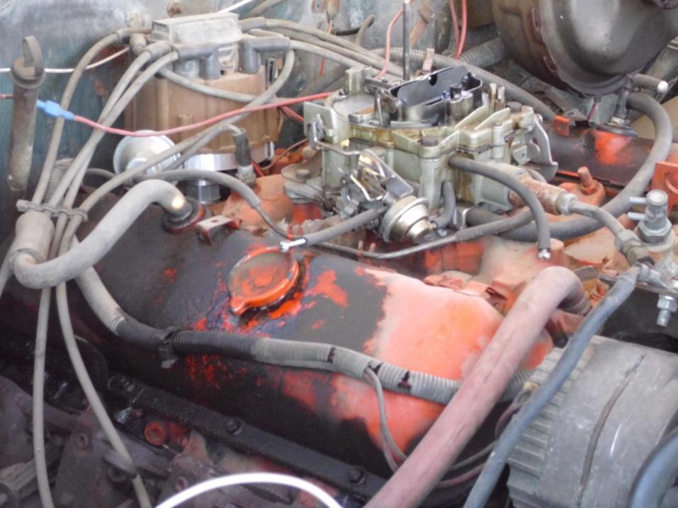

click pic for larger image i couldn't find a tag on 4 barrel carb don't know what kind it is

You see all the goldish varnish around the accelerator pump? That's usually a sign of a leaking accelerator pump. Probably doing it when your pumping rapidly, which means it's not pumping as much fuel as you'd think. I'd check it. It may not be all of the problem, and you might have a combo of problems. Do you know have your Vac Advance on the Dizzy hooked up? I do believe that's the ported vac line you have plugged with a screw.
YUP,You got You a bonified Qjet carb.
That silver round thing with the vacuum hose going to it,on the right hand side of the carb. that is the "Choke Pull Off",if that "Pulls" the choke open too wide when the engine starts then that is what will cause it to stall the engine.
hold the throttle wide open,manually push the choke shut,then let go of the throttle,holding the choke shut until the throttle is closed.Now the choke is "set",start the engine,"WITHOUT PUMPING THE GAS PEDAL" and see how wide the choke is pulled open.
iF it is more than 5/8ths of an inch{measured with a drill bit or some other device that is 5/8ths of an inch}it is probably too far open,it is adjusted by squeezing the control rod where it makes a U bend.
Too far shut and the engine will load up,too far open and it will stall when warm.
It does look to be a bit on the tired side,a good bath would make it feel like new again.:happy175:

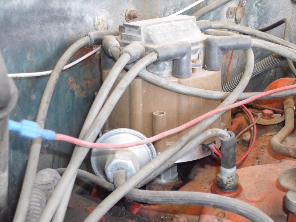

here's a pick up the dist click on pic to enlarge

i haven't perfected uploading pic's a complete engine shot this is the way i bought the truck haven't done anything to engine bay getting ready to change plugs
