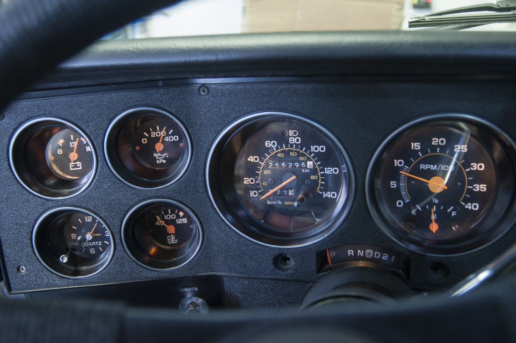

i made my own with both C50 and C10 cluster! :)

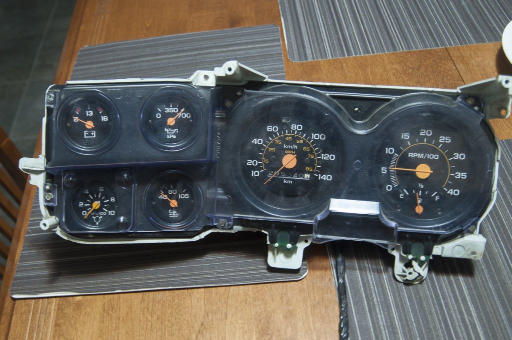

Most components should be the same on the dash. There are some c50 specific items like air pressure guages on air brake trucks, but most other guages should be the same or similar enough to work in a small truck with some minor modifications.
I saw one of those workhorses. Like you mentioned the difference is the bottom left hand corner using the air brake gauge. Too bad there isn't an rpm gauge to fit in that air brake spot!

im sure i can make it work, no clue what to do with port for ignition switch and choke on c50 cluster
I believe that the 0-4000 RPM tach would be for a diesel engine. The 366 and 427 tall big blocks gassers would have a 0-5000 RPM tach.
At least you have a nice place for a quartz clock.
