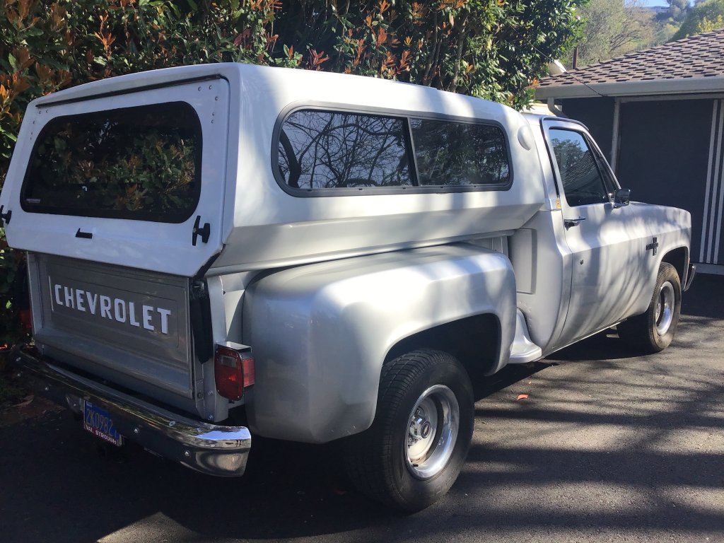

They came white, that’s why I did white, single stage.
I think the paint matched shell on the fleet side would work.

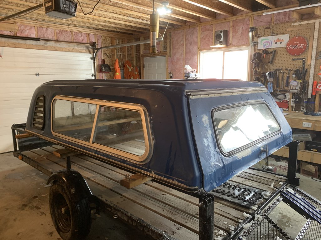

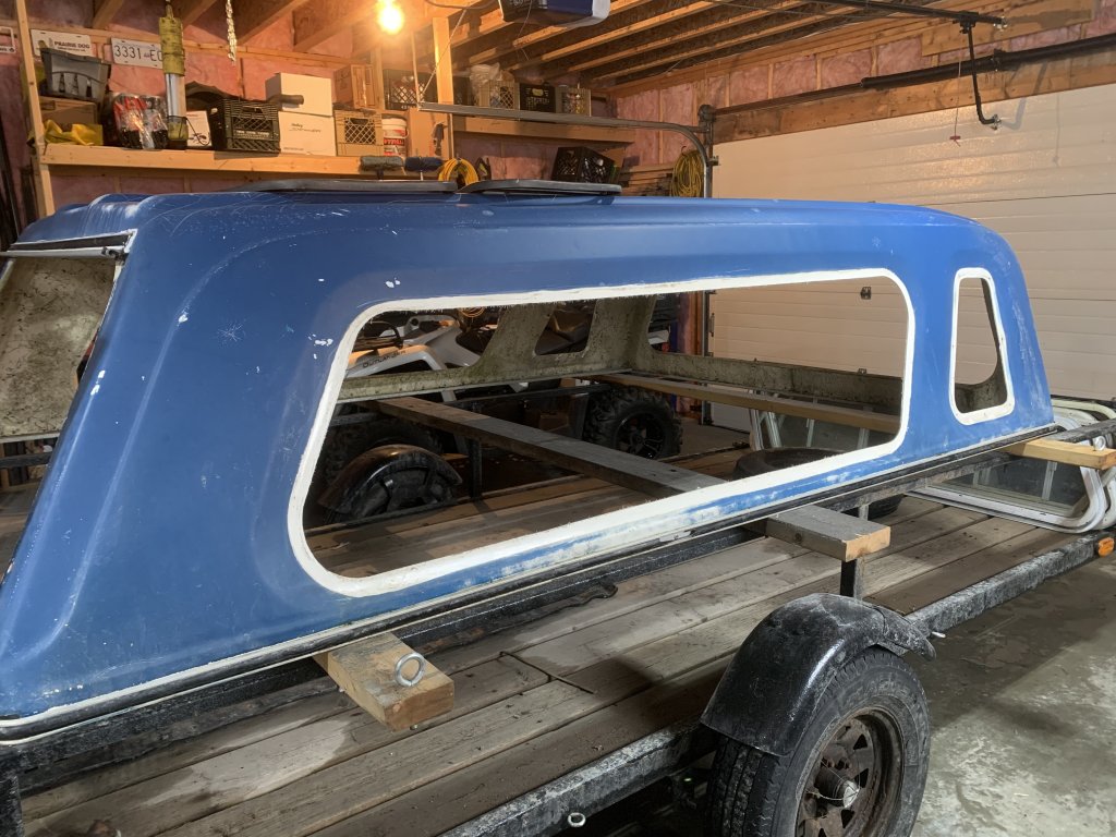

Picked it up yesterday. Free but I gave the guy $40 for it. All I had on me. Looking for one for a year. All stripped down. Some prep work to do now.
