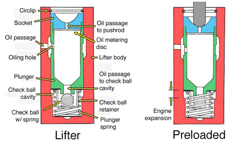

Maybe excessive pre-load or a sticky metring disc on that lifter:
EVER WONDER WHY WHEN YOU PRELOAD THE LIFTER MORE THAN ABOUT A 1/4 TURN ON THE ROCKER ADJUSTMENT NUT THE VOLUME OF OIL SQUIRTING OUT OF THE PUSH RODS DROPS OFF RAPIDLY,
The seat in a hydraulic lifter rides on a cushion of pressurized oil, oil that's displaced up the push-rods as the cam lobe sweeps under the lifter base, as the lifter returns to the cam lobes base circle the lifters seat is pushed back up to full height by oil pressure (one reason lifters tend to click with low oil pressure)
the potential problem is that the total distance the seat supporting the pushrod moves is usually about .055 thousands, a full turn on a rocker nut is usually .040, so the more you preload the lifter the lower the volume of oil under the lifter seat
picture may help
