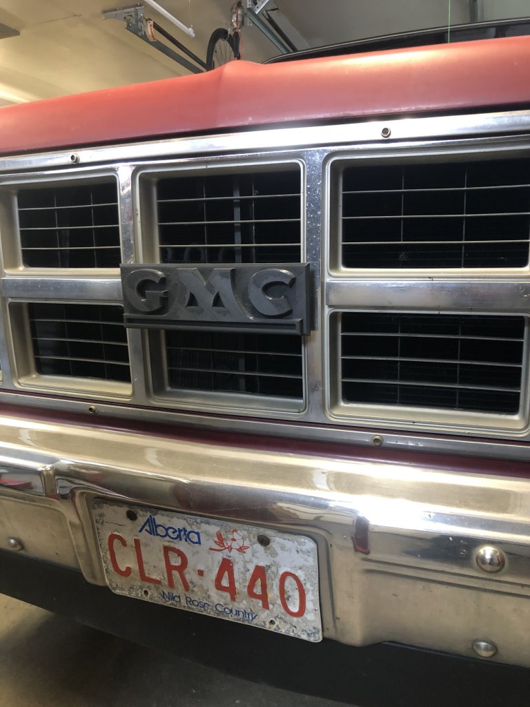

Everyone from the North should know the answer. It’s called a winter front, it fits in front of the grill blocking off the cold air coming threw and helps a lot with cab temps. There is usually a couple of flaps sewn in that can be opened if the ambiant temp climbs while you are out cruising. I don’t have my truck with me right now but if you look at the photo you can see the snaps install to which the winter front attaches.
For those of us who a REALLY cheap, a piece of cardboard works great and it’s basically free.
There is a flattened pizza box wedged between the radiator and A/C condenser on my Ram truck as I’m typing this. Even with the engine block heater, it takes quite awhile to warm up when it’s really cold. The cardboard does help the engine warm up faster, and help keep heat in when it’s really cold.
Just make sure you remember to remove it in the spring!!!

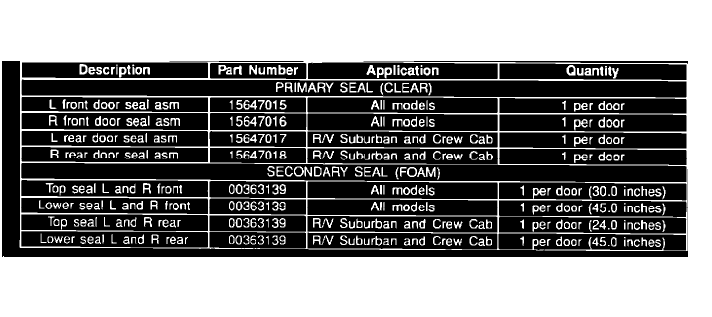

There was an extensive post about door insulation recently. I think it was about 6 months ago.
Needs some 1930s shutters for a tractor
Engines run cold on kerosene , silly little low compression quirk of the era. And kerosene doesnt combust very efficiently cold, like you wash your cylinders and fill your crankcase if you run it out of the temp range.. if you use your shutters and switch from gasoline at the right time, then you dont need to drain nearly as much kerosene from your oil so much. saving you time on for other fun things
