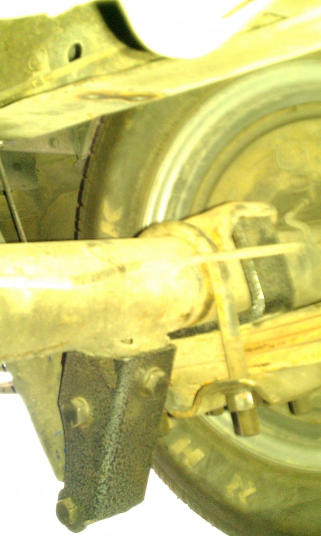

Western Chassis, Bell Tech, CPP, McGaughys are all good kits. Me personally I like CPP spindles and Western Chassis flip brackets(with gussets) and shock extenders.
Would definitely prefer a flip kit that had been used with out having to notch.

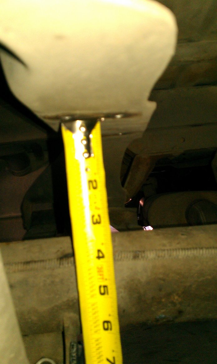

You don't have to notch with a flip kit if you have at least 5.25in between the frame and the top of the leaf spring at ride height(.25in bracket, 3in axle tube, 2in minimum travel). In the pic below you can see I had a flip with 6.75in at ride height(.25in bracket, 3in axle tube, 3.5in travel).

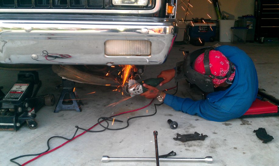

You might need to lightly trim the lower leading edge of the lower control arms so they don't rub when turning at full lock to lock.

I would do a 2.5in spindle and 1in drop spring and a flip in the rear, that will give you a 3.5/5in drop and it will reduce the factory "rake" from 2in to .5in. It might cost a little more but well worth the money. FWIW, a 4in drop in the rear is a pita if you dont have the right tools to get the rivets out of the hangers.
4.5" grinder and a couple of cutoff wheels and a grinding pad. about 20 mins per side.
