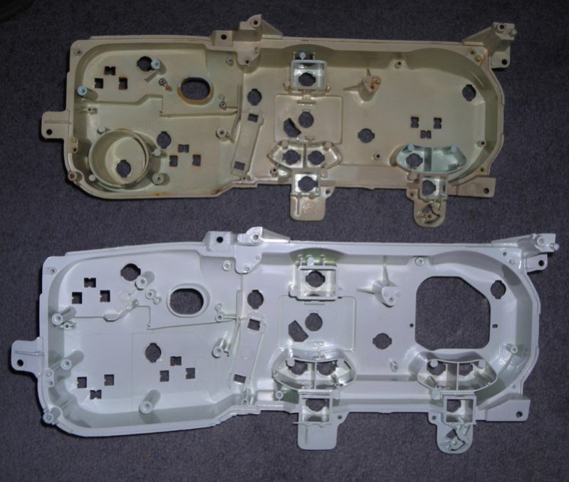

The factory tach bezel housing is just the non tach with an opening behind the tach. So it would be very easy to take a non tach housing and dremmel an opening behind the large fuel gauge. It is simply there so that you can access the pins on the back of the tach as the tach does not connect to the circuit board.
So cut an opening, install the small fuel gauge where the clock would be and install the tach circuit board.
You still need the Tach circuit board, the Tach and the small fuel gauge.
Just trying to clarify about the factory tach bezel housing vs the non tach housing.

The bottom pic is what a tach housing looks like.

your picture = 1024 words.
It appears that the tach-able housing ALSO includes mount points for the lower left gauge (needed) and removes some weird circle.
the blue looks an inch or two wider in the pic - its just a perspective issue from the pic right?
