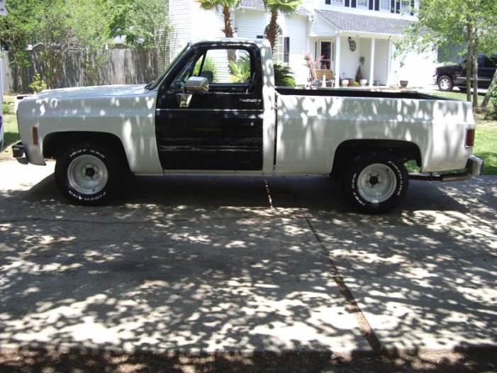

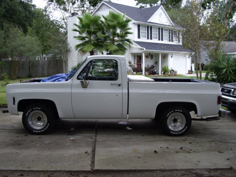

Like he said. When I got my 74 the previous owner had upgraded it with 83 doors with PW/PL.
