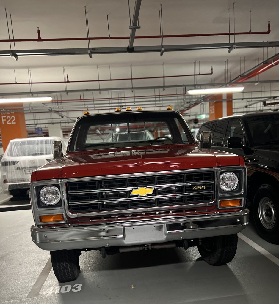

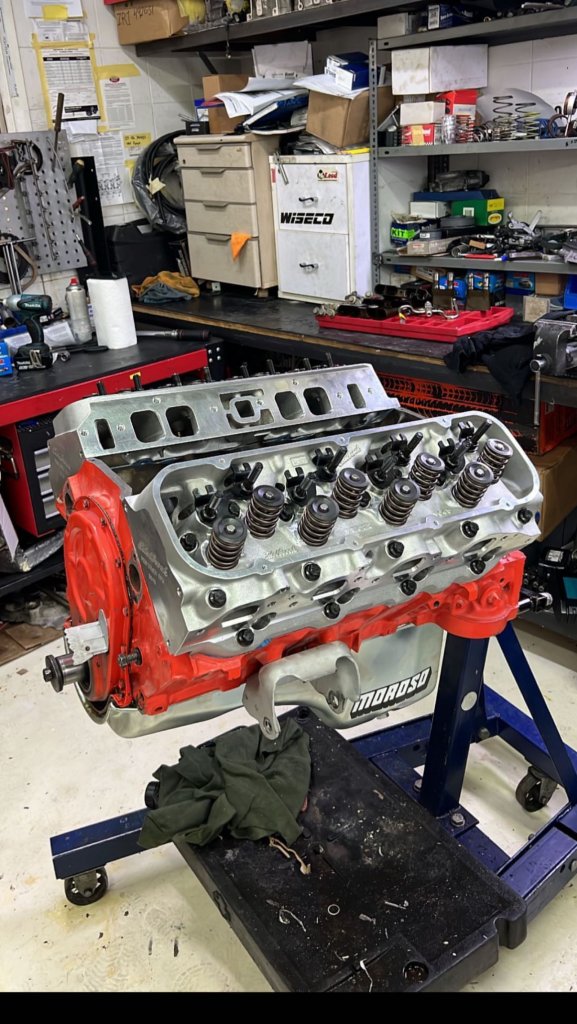

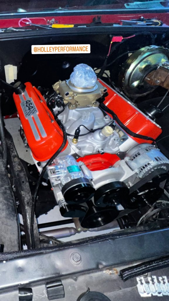

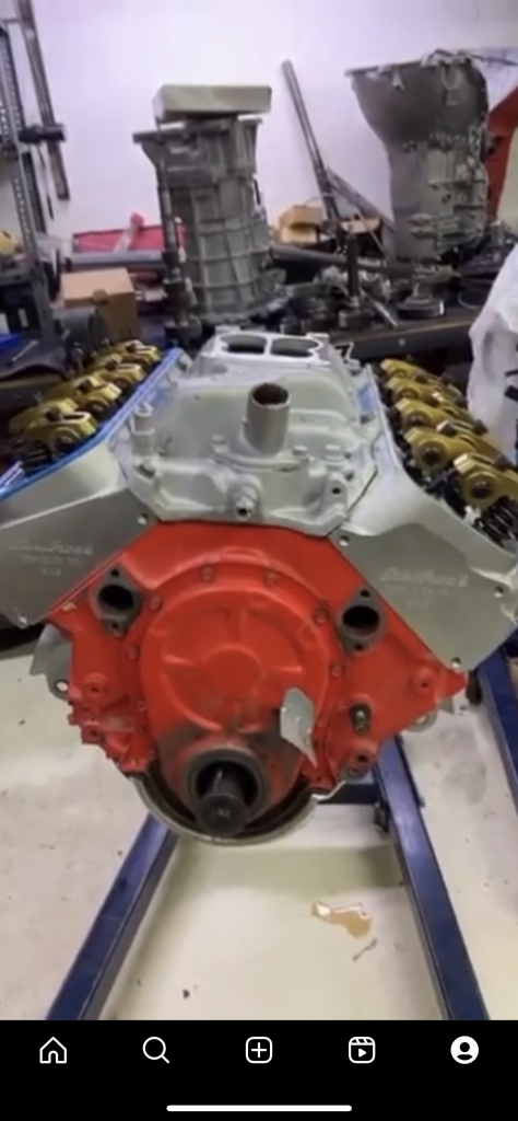

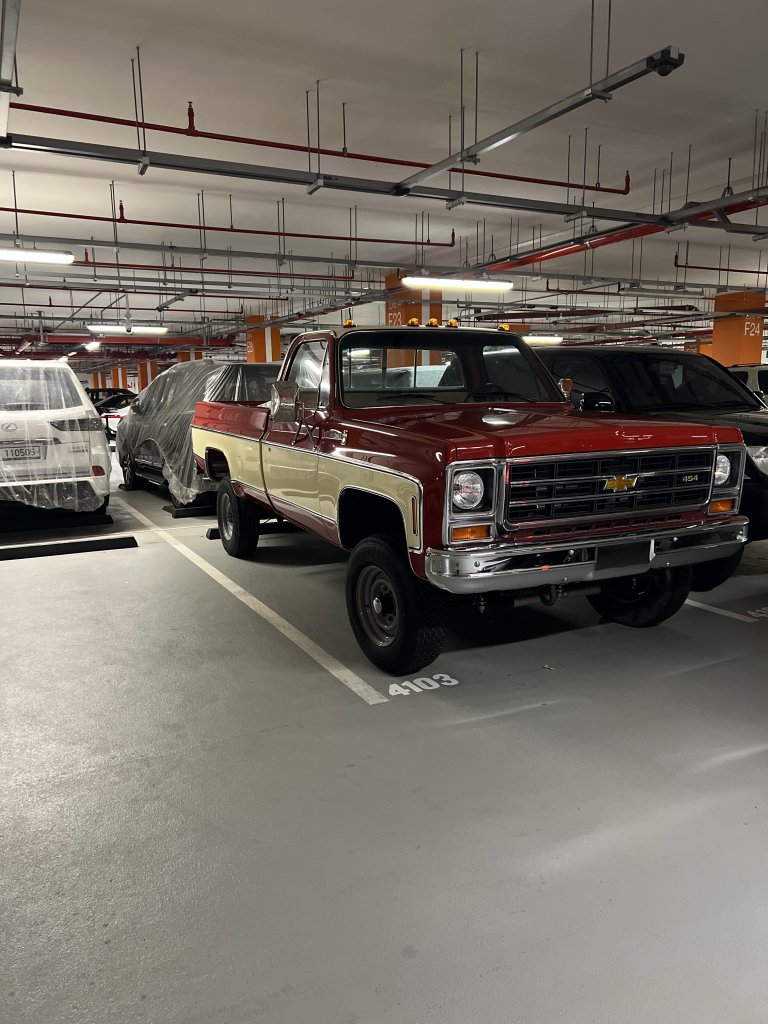

Hello this is my second square body and it’s a 1979 Chevy k20 with a 468/4l80e(no transfer case at the moment waiting for the 205 to arrive). The 468 had some work done to it, Holley sniper, aluminum heads, intake, big cam, and pistons. The compression last time checked was 12.8. The trans is rated at 1000hp so no worries there. My question is I live in a very hot climate, Qatar. Can I drive my car regularly or just in the winter and what should I check maintenance wise regarding internals. Please note I did not build my truck I payed a highly skilled team of men to do it for me. I will upload pics and a link to the video:-
