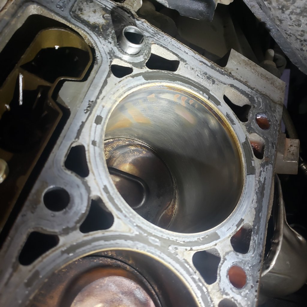

So one of my workers 2018 chev decided to wonderfully have the afm lifter fail. So we tore it apart tonight only to find some pretty substantial rust on the backside of cylinder 7 the failed lifter cylinder. It was smoking white when we pulled it into the shop. I also got some pretty good lines in the rollers on the lifters so I'm thinking it needs a cam aswell. But the cylinder wall scares me is worth fixing
