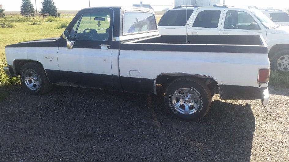

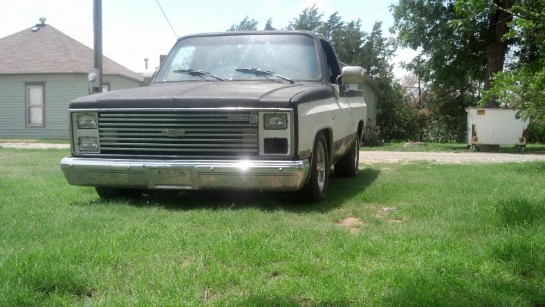

The picture is my truck and i have since raised the front 2in. and lowered the rear 1/4in and the day pic was taken the headlight glass just shattered (I have since replaced it)

Can we get a pic of those rims? :D

Rims
Best I have right now. My DD is right next to it.

I never saw those ones before

I haven't either but I love them. Hard to keep them nice and clean tho.
I haven't either but I love them. Hard to keep them nice and clean though. Got them from my father as a birthday present if I remember right.
