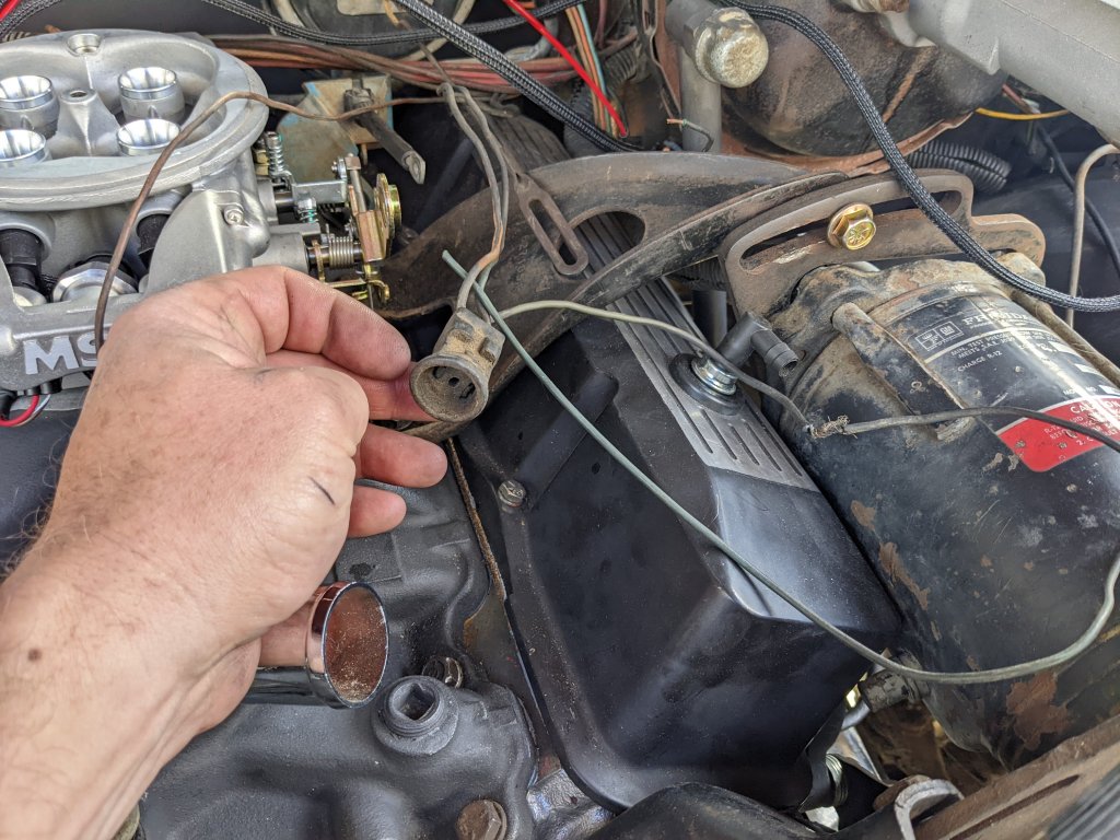

Alll that being said, I have a connector I don't know where it goes and one of the wires is broken...so I have a three part question I guess:
1. Anyone know what connector that is and what the three wires are?
2. Is it possible I have an 1981 Suburban with no electronic module or more likely the previous owner did a fairly complete job of ripping everything out?

as far as a module, Im thinking the only module in a 1981 would be an Ignition control module, and thats inside of the distributor, jus a guess but that connector kinda looks like a oil pressure sending unit connector

What you are thinking of is the ESC that was only on the 305. It used a knock sensor to pull timing when necessary on the 305. The connector in your hand is for the High idle solenoid that is supposed to kick on and put the idle up when the AC is activated. The other side of that wire should be going to the AC compressor clutch and it activates the clutch and solenoid at the same time. You won't need any of that with the Atomic EFI, but you might have an input on the MSD ECU for that signal so it knows to kick the RPM up when the compressor engages. You will also probably need to fix that wiring to remove the connector so that you can engage the compressor as well.

You are correct that the Atomic has a kick up provision..and your also correct as I started tracking the wires that it looks like the wire going to the compressor clutch from that connector has been spliced more than once, some repair is in order...I was pulling on it and it disconnected at a shoddy crimped connector back by the firewall!
I couldn't find a wiring diagram to show the idle solenoid/AC route but I think the AC sends 12 volts to activate the solenoid when the AC get turned on? It looks like the Atomic is just looing for the same 12 volts to kick up the idle? I think I can just zip tie that whole connector and wiring against the firewall disconnected?

If you don't have functional AC, then you dont need any of that. If you have functional AC, I would fix that wire and connect it to the AC clutch. A simple wire tap will let you take that signal to the Atomic ECU for the automatic idle kick up function.

Are you sure about that? It appears similar to the connector that attaches to the oil switch on back of the motor that sends power to the choke thermostat.
No, I'm not sure... but I believe an 81 would have been a hot air choke from the factory, not electric.

Just thought I would ask. My 81 K20 350 has an electric choke and used the oil sensor for power. Looked very similar.
