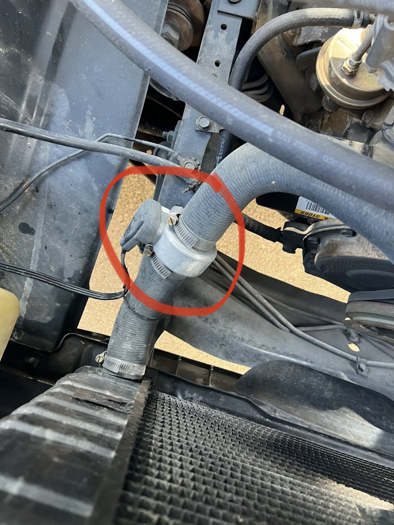

Thanks for all the help! I was looking at replacing the radiator hoses to see if they were leaking and was trying to figure out which ones I needed and saw this on the low side radiator hose. I have no idea what it is so any help would be appreciated!

I've had good luck finding leaks with dye and a UV light and/or a radiator pressure testing kit.
