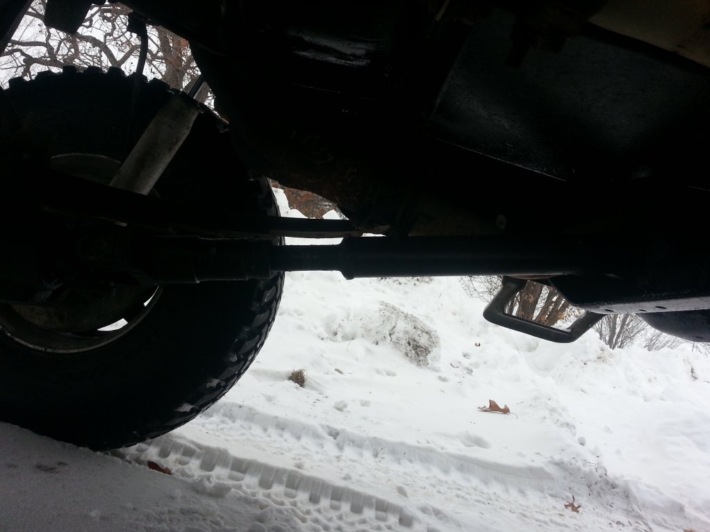

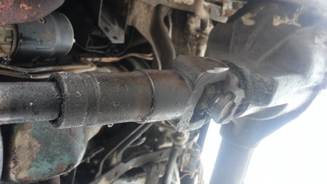

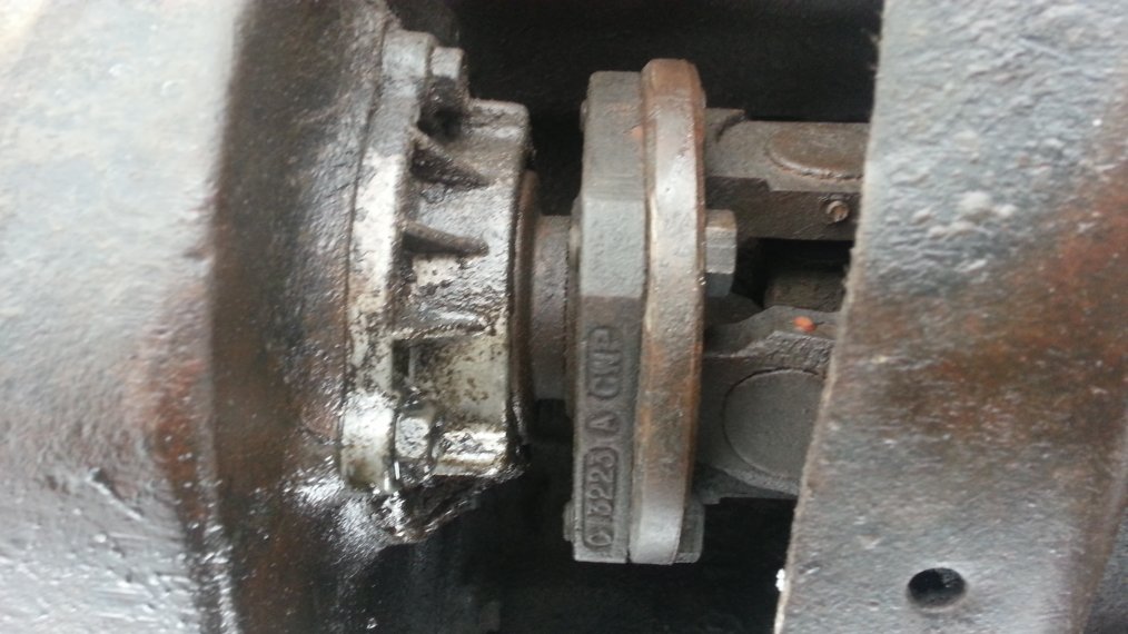

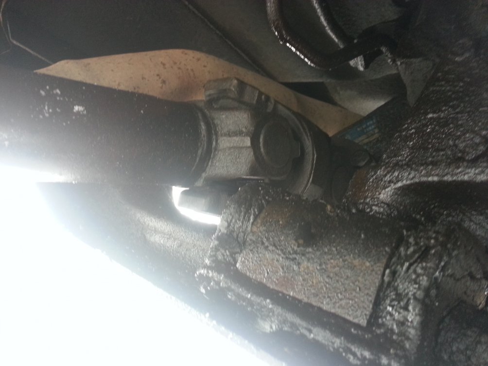

Its lifted 6 inches ill post some pictures of the drive shaft.

In the pics that looks like the factory drive shaft with the double Cardan joint on it. Very possible that double Cardan joint is wore and sloppy. Especially being run on a lifted truck, they take a beating. Check the other U-joints for slop and replace if necessary. That is quite a bit of an angle looking at that lift, I am guessing it is a 6"?
