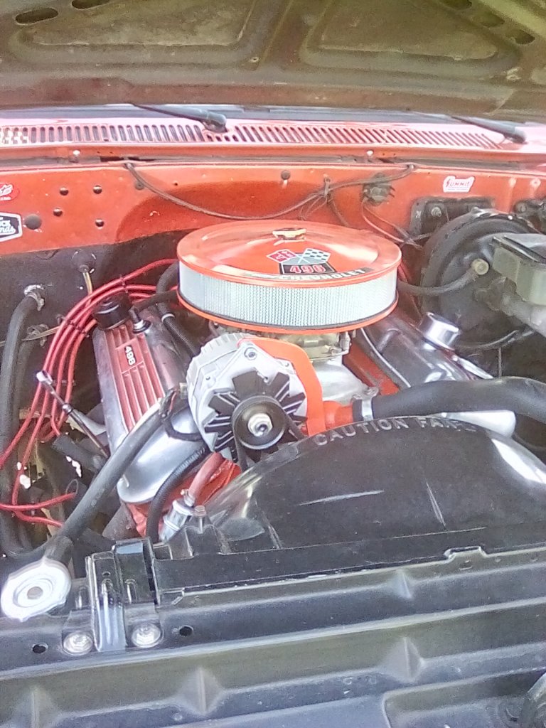

Shorty81
Baby Boomer
Mar 19, 2018
2,885
5,145
North West ohio
Darren
86
496
Either one would make plenty of power. Leave modern engines for modern trucks. My old Mark IV 496 is a great ol' mill.
