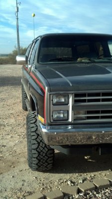

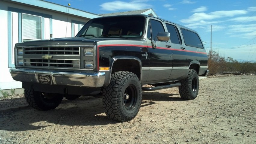

This is my 88' Suburban 3.5? gears with a Rough Country 2" lift and 33x12.50x15 on 15x10 wheels with 3.5" or 4" backspace. The measurement falls in between, like 3.75". I can't be positive though because these wheels are like 35 years old off of my dads old J10 Jeep.
They barely rub the front and rear of the fender wells because the offset is so far but I massaged the wheel wells a little and it's good.
Having a 2" lift with 33s I'd say I would have to go 35s with a 4" lift.

I drive it to work once a week, completely flat ground, 55-60mph and it's perfectly fine for that. But this is my weekend rig. It's usually 4 wheeling in the rocky desert of Arizona.
If you're asking because of the gearing, yes it is too tall geared but I never tow and I use 4 low when needed and that's low enough for me. Or do you mean does it rub on flat ground, no it doesn't, it only rubbed when in off camber situations off road. Now that I've massaged the fenderwells it takes a good bit of flexing to get it to rub a little, not enough to tear anything up though. And I still have my sway bar connected.
I do see a set of 4.56s and lockers in my future though.
