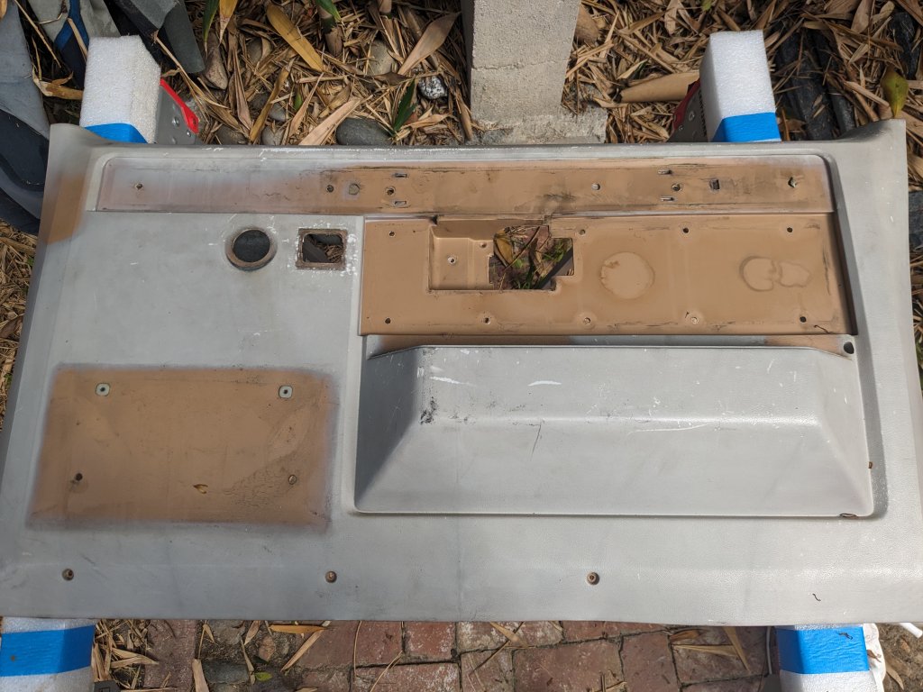

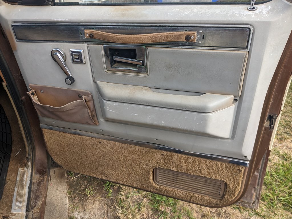

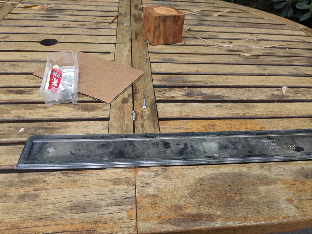

SirRobyn0 inspired me to try my hand at restoring my door panels as I was stripping the interior to send it to the paint shop. As he said in his thread, are they concourse restoration- no. Do they look 1000% better than what I had-yes. I didn't pay the gouge fee for Chinese plastic parts and I feel I learned something so the $100 I spent in parts combined with the, uhhhh well lets just say a few hours, vs the $800 it was going to cost for new is a wash to me...as my kids said when I asked them if I should have bought new and they said "It suits it."

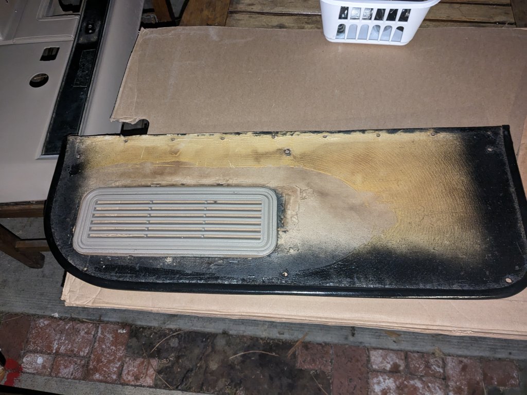

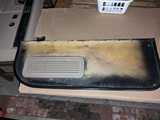

My original post got corrupted so I'll try to narrate the big parts...

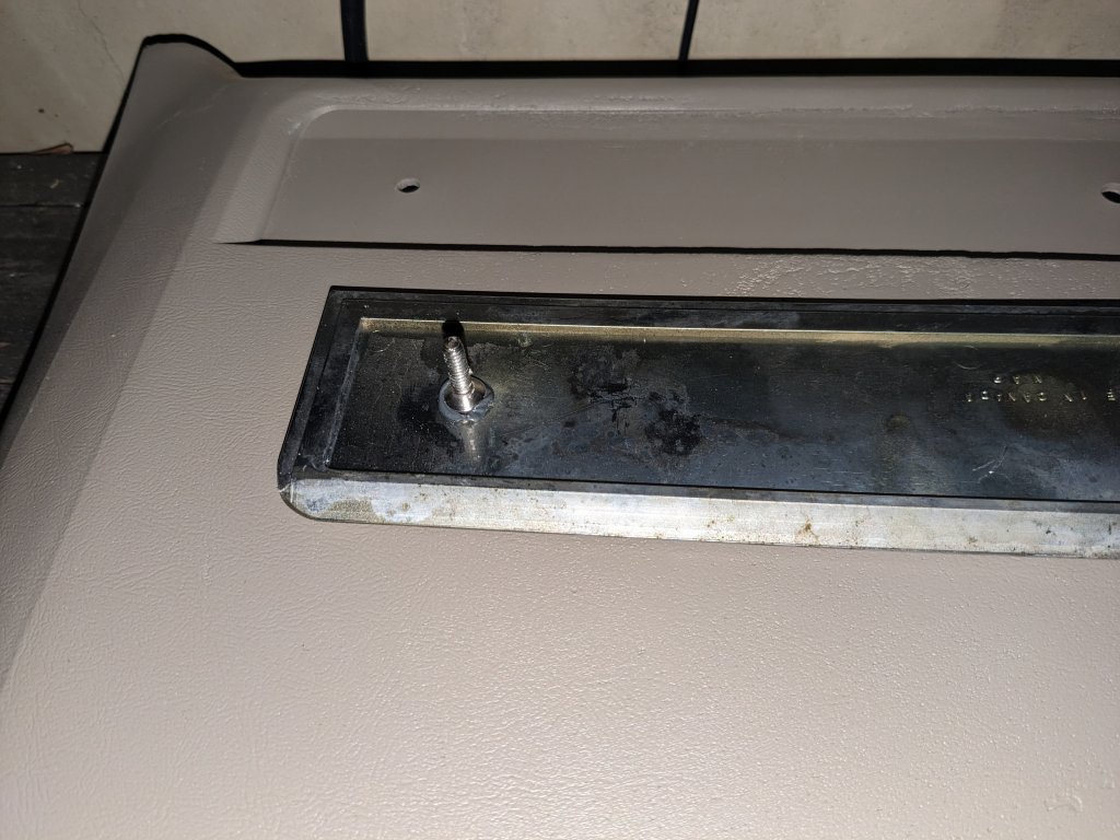

I took JB Weld and stainless steel screws to replace missing posts.
I tried to recolor the carpet with Krylon Fusion but it didn't work so I replaced the carpet wit new from fabric store
I used SEM medium neutral as the panel color
I think the finished product looks pretty good, it's a custom color combination so I couldn't really order it anyways.
Would I do it again? Yeah, I probably would because I learned a lot.
Here is the finished product off the car

It looks great!
How did you replace the fabric, did you cut the stiches out and re-sewn the plastic trim around?
I'm always afraid of painting plastic, is this paint tried and tested to have good adhesion?

It looks great!
With the fabric, I carefully cut the existing from the front...pulling the stiches didn't look to hard but I was afraid the sewing machine I have would be able to put it back. I think the fact I went with black helped a little with any imperfections around the perimeter.
I used the SEM Color Coat on my 2003 Suburban center console and it lasted 11 years with minimal rub off and zero discoloration. It's a good product

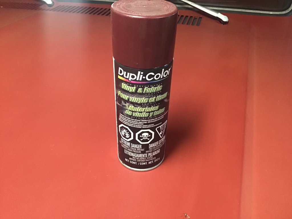

C1500

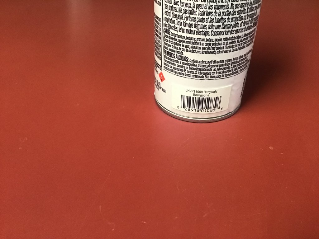

My original panel and it had turned to a shade of purple. Duplex interior paint in a rattle can just happened to match the original color. Very happy with the way it turned out.
Is it Dupli-Color? Do you know the exact type/code of that paint? My panels especially in cargo area could take some renovation too and yours look great! How durable is that paint?
Oh yes! The can was out in the garage and I forgot the true name.
