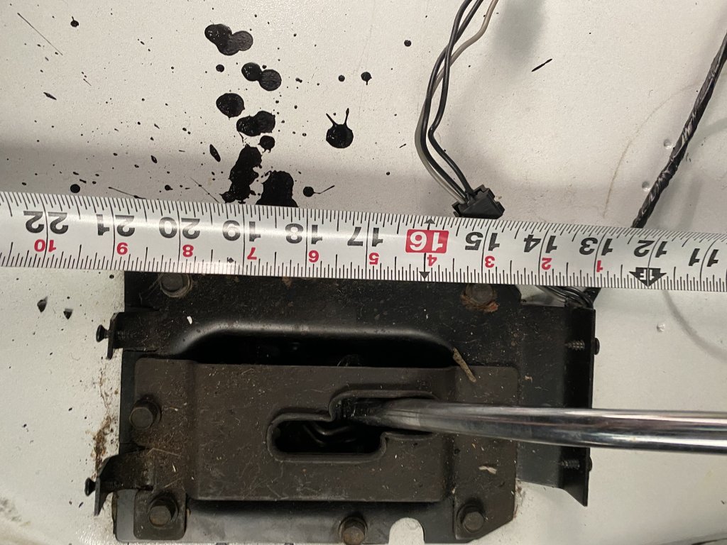

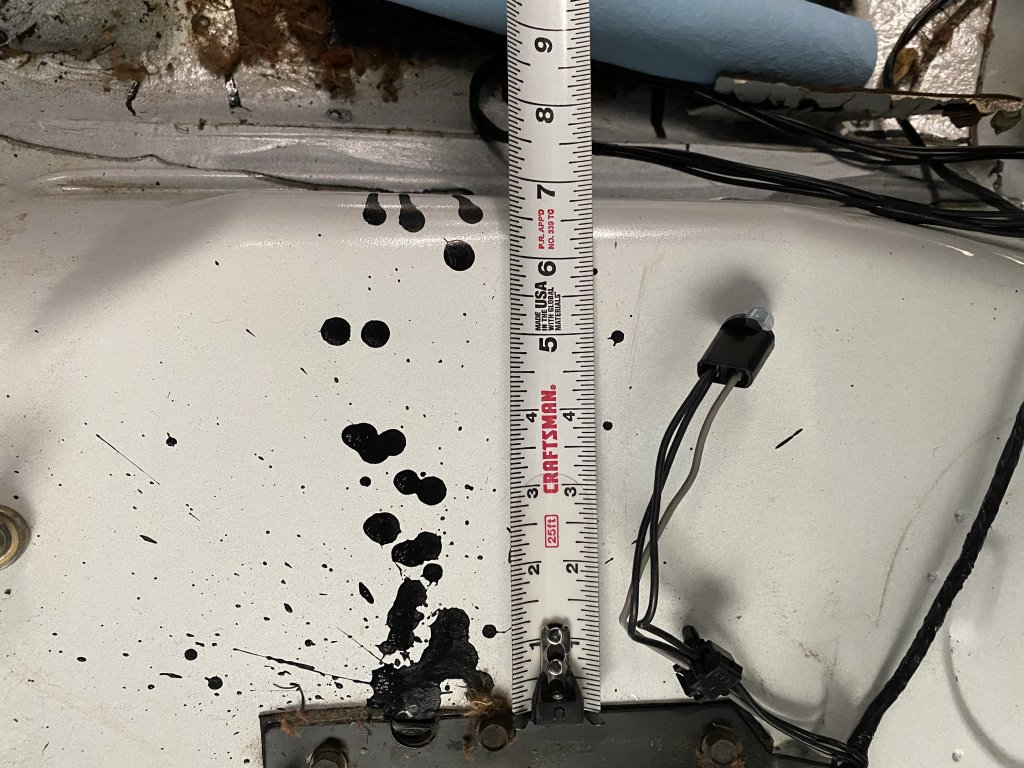

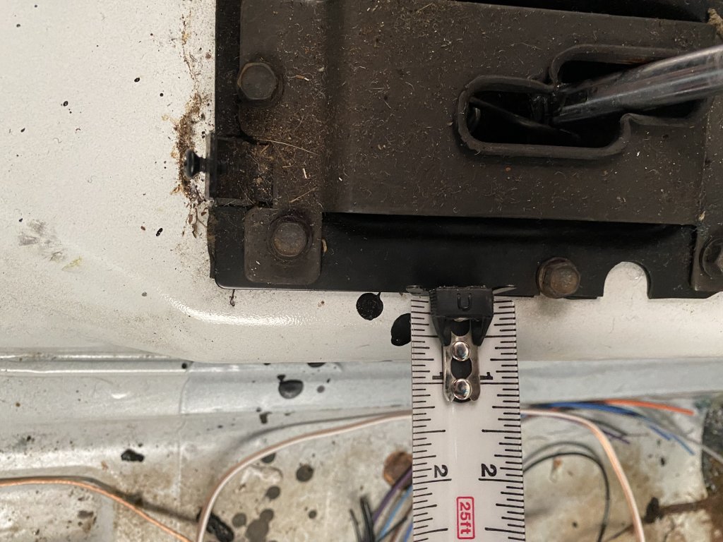

700R4 with a NP241.
From the firewall to the shift plate
From driver side
From passenger side

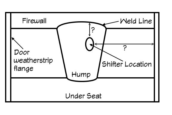

I hacked up a quick drawing. The question marks are either to the edge of the cutout, or to the center of the hole, your choice.
P.S. Just scrolled up and saw you beat me to it. Thanks, zelph, I'll see what I can make of this. And the old cab is a pile of melted steel, long gone...
