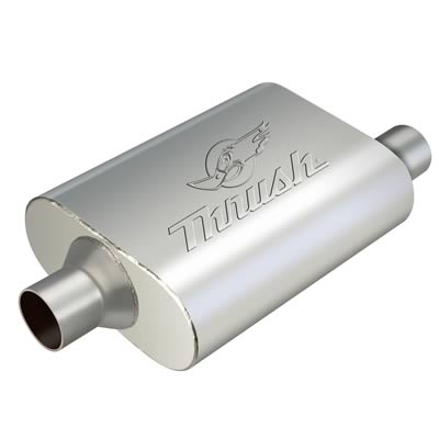

thrush welded muffler
its pretty much a copy of the flowmaster 40 series I run them on a lot of my trucks.
with headers dual 2.5'' pipe dumped out right behind the axle in my 71 c10 with a mild 350 it sound like a muscle car deep throaty growl when I romp on it but a mellow rumble at idle I love the way it sounds
on my 90 jimmy with manifolds and dual 2.5'' pipe out the back they are a lot more mellow but still sound awesome
headers or manifolds change the sound a lot and so does your pipe and how you run it.
I hate 3'' pipe everything I have seen with has a ****** sounding echo
I run 2.5'' pipe on everything of mine even my big blocks
and the best part is they are around 30 bucks a piece
mike you might have a piece broke off inside the muffler rattling around I have seen that happen on a flowmaster 40 series sounded like hell
Could be... I'll have to crawl under it and tap on them a bit listen for something rattling. Or start it up and dive under before they get too hot and listen to see if one is different than the other. Need to do something as it is pretty bad. Maybe back when I was 15 I would have liked it. :Insane:

X2 on the Thrush Mufflers
I used those too.
I found they create a very loud back pressure noise and at just the right RPM around 1000 it is so stinking loud you cant hear your self think lol and it vibrates all the sheet metal on the truck until the body also resonates a sound.
I have often thought of going with straight exhaust for now just to be rid of that awful drone sound.
I think it is because they are offset and the exhaust literally does a u turn inside the muffler.
