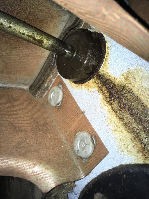

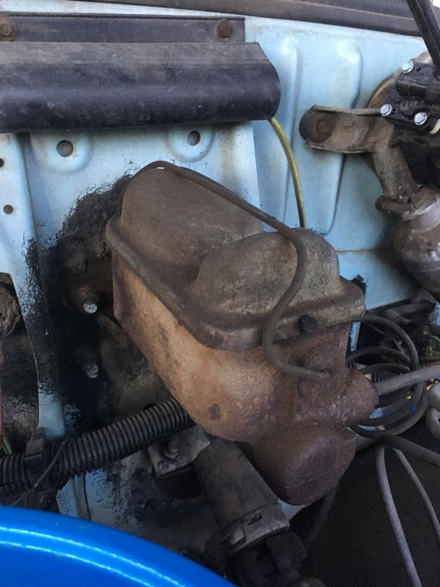

I was looking at my stereo wiring today in preparation for an amp installation when I saw this at the firewall.I'm including a picture of the engine side also. Are all rebuild kits the same or is there one in particular I should be looking for?

You need a kit for a JB1 M/C

I always replace them with new. Master cylinders can have pitted walls which cause major headaches.

I'm actually going to buy the whole MC but I'm seeing bore sizes of 1" and 1 1/8". Maybe I'll pull the existing one and take it with me to the parts store.

Be sure to get some brake cleaner and spray that firewall off clean. Then spray it with some WD40 or other lubricant. That brake fluid leaking there will eat up and cause your firewall to rust away and give way when you hit the brakes real hard someday. Get a handle on that ASAP and stop that rust problem that is going to happen.
