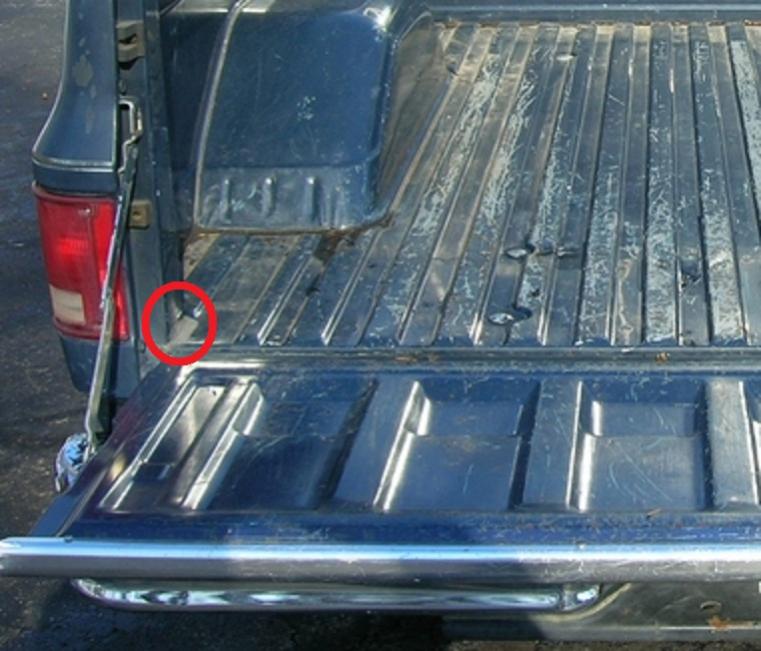

If you mean the whole bed side they bolt on. Theres a few between the cab and bed, a bunch in the wheel well, a few under/near the back, and you'll need a grinder to cut the spot weld near the back of the bed side, at the bottom of the rear post in the floor of the bed near the tailgate. It's dark out here or I would take a pic. I'll look around and see if i can find one.

alright so the bedside requires welding i cant do that so im either going to replace the whole bed or idk yet

You can just bolt the bedside back on but to remove it you will need to grind out a small tack weld in the area where the red circle is...
attachment.php
You'll want to have someone weld it eventually, it keeps the bedside from flopping around and keeps it lined up so the tailgate closes right.
