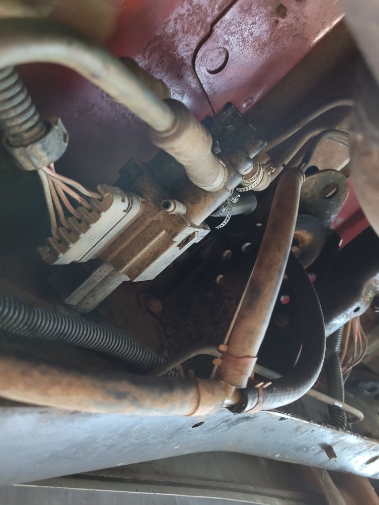

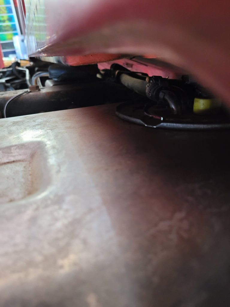

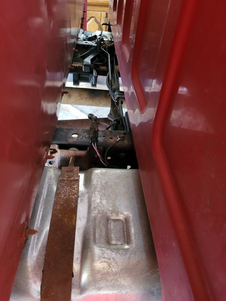

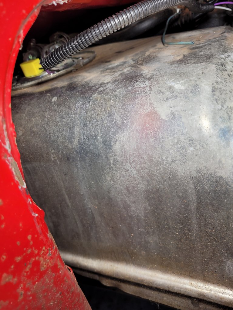

No I'm still here and fiddling with this issue. New member and unfamiliar with where to post. Yes the truck is carbed, as for hearing the fuel pump(only on the right side) it's the sending unit priming the fuel line just before I start the truck. Can not hear the same sound when the switch to LH side.Tanks are new, sending units are supposedly new. Fuel hose lines look new besides the metal the lines that go across the frame. I have searched many duel tank, switch, valve switch, and gas gauge threads. To which I have taken all the info and have applied. I know I'm not having power issues as to which I can flip the switch and hear my valve go from RH to LH. I just ordered a multi meter to check voltage.

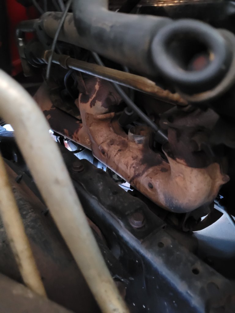

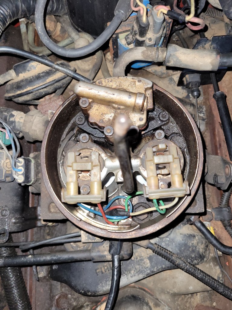

@Jcoronado09 I hope I have not offended you with that, we get guys with all kinds of experience levels here from pretty much experts to very green. Would it be to much trouble for you to take a picture of the passenger side of the engine block down lowish, and another one looking down the throat of the carburetor? It seems like we must either be working on a TBI system or something that someone has made changes to in one way or another at sometime. Thanks.

No your all good. Here are the pictures. Just got home and going to test to see if I have fuel flowing the line and check voltage.

Yup, that's a TBI system, if you look in the second picture you can you can see the wiring and the connectors for the fuel injectors. A TBI system is just like that 2 injectors on the throttle body. I'd test that left side pump next.
