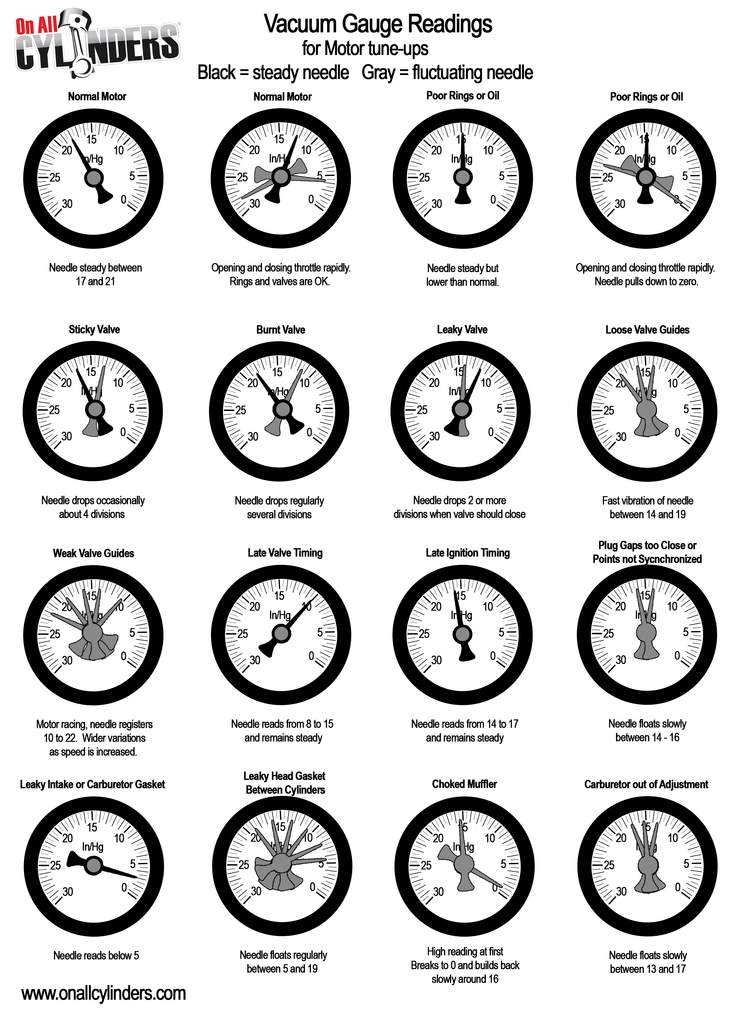

A week ago my truck sounded like air leaking a little and seemed down on power. My grandson was driving so really not sure about the power. I read a thread about valve train problems. I hooked up a vacum guage to it. When first started it was just in the Lateing Timing red. After it warmed up it was in the Normal Motor. I read where the needle should be steady. The needle was moving 1 to 2 marks on the guage. Is this enough to indicate a problem?

Read this article and reference what your vac gauge was doing and then you'll have an idea where to more closely inspect/troubleshoot.

I was thinking a consistently moving vacuum gauge in the same area was valve leaks, or I guess I should say, valves not sealing.
You said it maybe lost power, your answer may lie there?
Loose rocker arm? Broke spring? Bent pushrod? Flattened lifter or cam lobe?

A fluctuation in the vacuum gauge is due to one cylinder not functioning properly. This can be for many reasons. Worn cam lobe, mis-adjusted valve train, broken valve spring, broken piston rings, worn/leaking valves, etc...

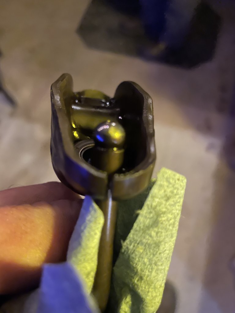

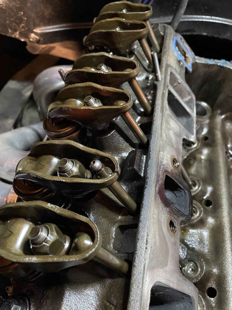

Last time I was down on power I found this joy in the top end, keep in mind my vac gauge was swinging wildly at idle, couldn’t really call it an idle tho lol.

Ok so I'v been crazy busy lately. This morning I removed the valve covers. No broken spring or anything else I can see. I adjusted the valves. Cylinder #3 had a small amount of water come out as I rotated the engine to set valves. Can a intake gasket let water into the cylinder? The reason I ask is I have had coolant on the top of the motor along the intake and the head for a while. I had trouble getting the upper hose to seal at the thermostat housing and thought that was the source of the coolant on top of the motor. Maybe gasket all along??
Maybe a compression check next. What ya think?
