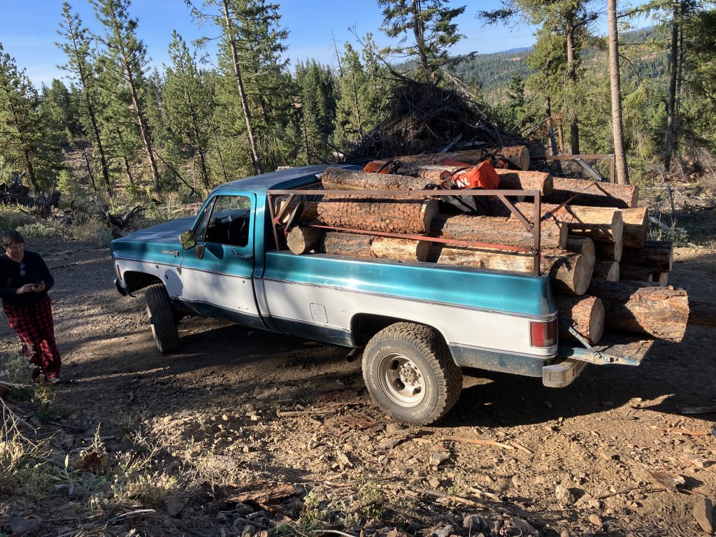

DoubleD, I have a Yukon lunchbox locker, 4:10 350 turbo, 454, 12" 33's and it has been unbreakable. Off road, with big loads of wood, untold burnouts, it has never let me down.
Start at post 35 for a pictorial install of befor mentioned locker.

yer - got some toothpicks in the back of that 'un alright ..
