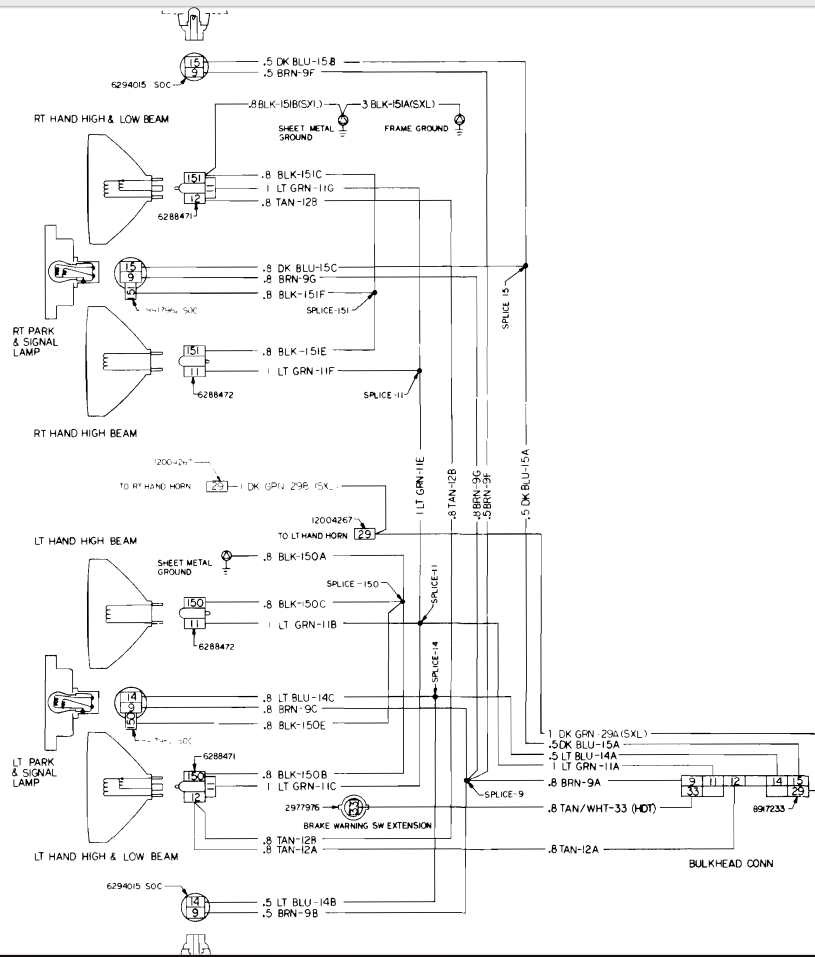

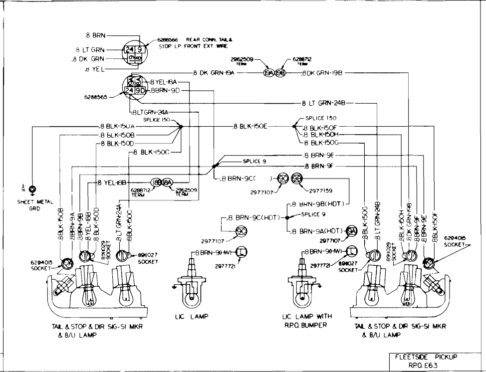

wiring diagram LINK
In case you didn't have the wiring diagrams. 1980 or 1983 should be pretty much the same as 1982.

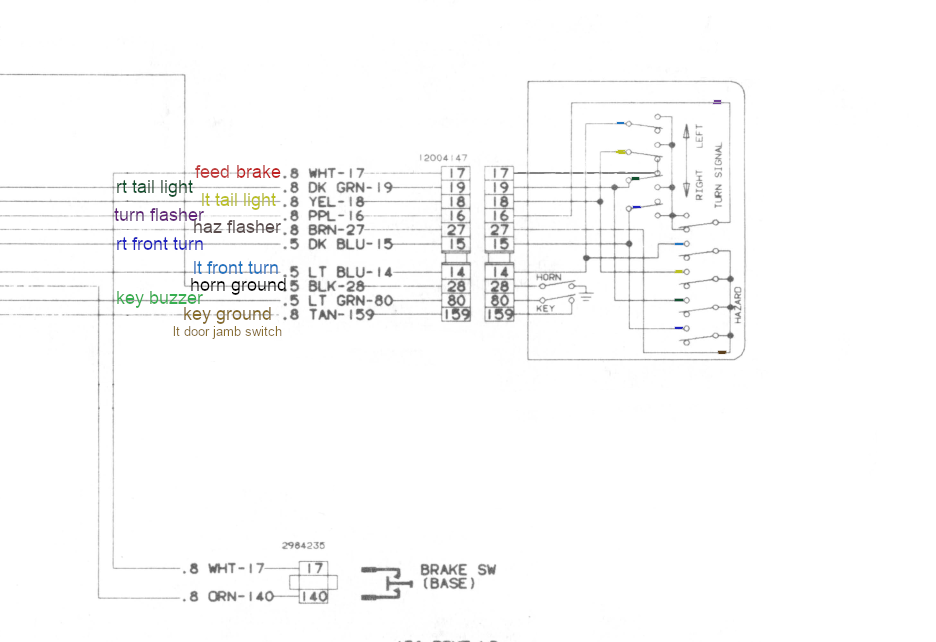

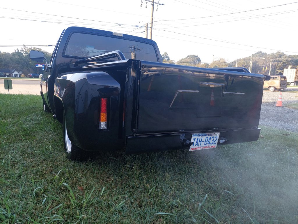

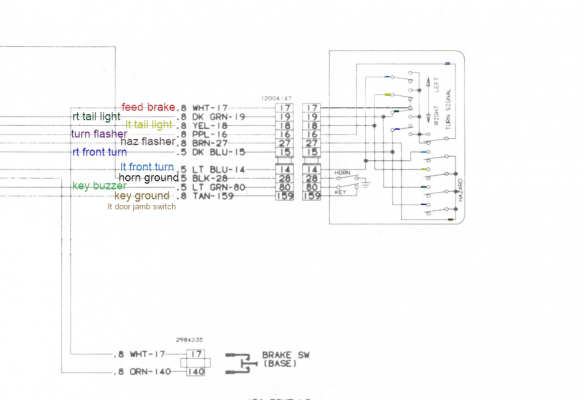

The diagram of the turn signal switch just solved my problem. Intermittent no brake light starting with the right side 6 months later killing both brake lights. I am a 64 year old shop owner and piddler so I had to try and help out our customer. This is his 81 step side. We used some aftermarket camper lights for the square holes already frenched in the fenders. Used a $24.00 break out box to separate the feed for signal lights and brake lights. First butcher shop paint job was peeling and rocker and rear cab panel were killed and filled. Came out nice. Axalta base and clear.
