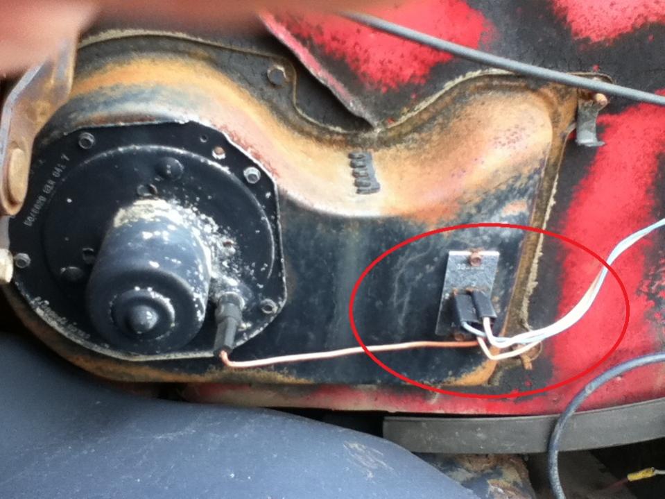

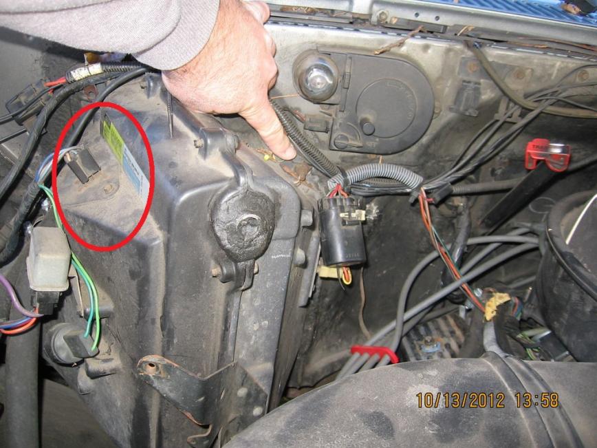

Here is the locations:
A/C Housing:
attachment.php
Heat only Housing:
attachment.php

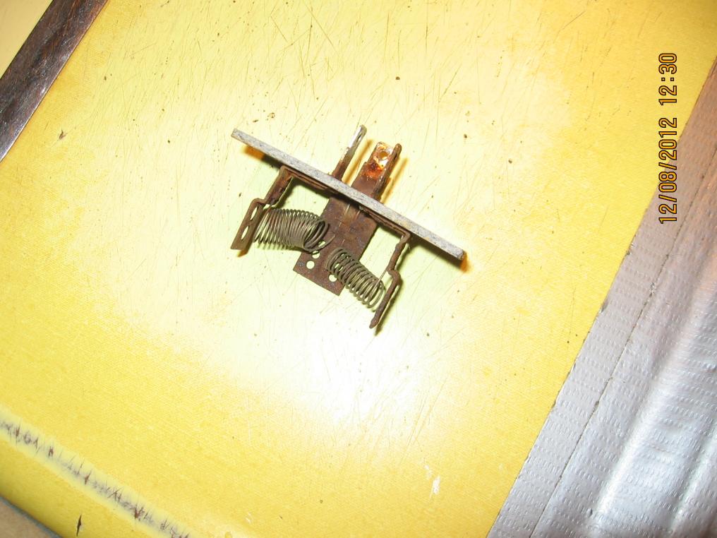

So you have an a/c firewall setup, even though it might not be on the selector in the cab. Somebody must have swapped in a different selector panel and messed with the system. Here is a pic of a resistor out of a heater only housing:
