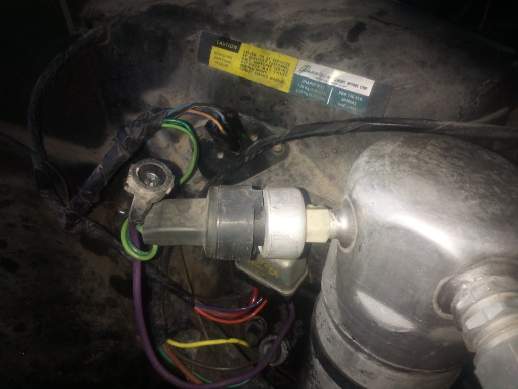

I am having a similar problem,my blower motor worked fine a few days ago,no weird noises or anything and now nothing. I can hear the switch select modes, def,heat and so on. Checked the 2 fuses(rear ac) both were good.
is there a relay to control the front blower motor?

If you have A/C there is a blower motor relay mounted on the A/C plenum under the hood. I’m not sure of the setup on a non-A/C truck.
On my ‘75 there is also a blower resistor pack/assembly on the plenum. The resistors are used for lower speeds, and high speed is a direct 12 volts.

I don't think my problem is the resistor, I get no speeds. It was working fine ,no sound and than just quit. Fuse looks fine. Any ideas? Thanks
High speed goes through a relay, the other three go through the resistor block.

So the relay like pictured above? On the a/c box? Thanks

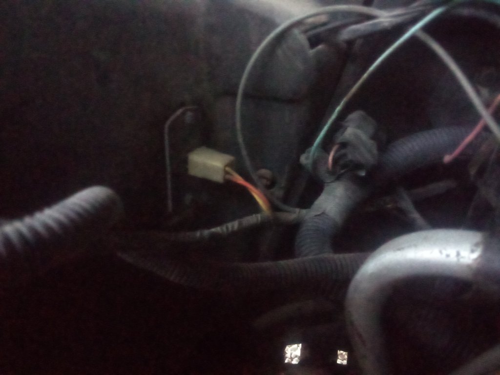

Any idea what would cause the blower motor to quit working suddenly?

Ground or power loss. Or blower motor just said it was done. It happens with anything electrical.
6,453
10,984
If you can close a relay and the fan works that eliminates power to the fan it also elimates the fan,the fan bearings,the fan ground etc. It's the relay itself or on the signal side of the relay. The relay takes battery power in and when the relay closes it turns on the fan. The relay is not closing on its own. 2 wires of the relay 1 is 12v in and one is 12v out to fan when closed the other 2 close the relay 1 is ground 1 is switched power when switched power hits the relay an electromagnet pulls the points in the relay closed which supply voltage throigh the points to the blower.
