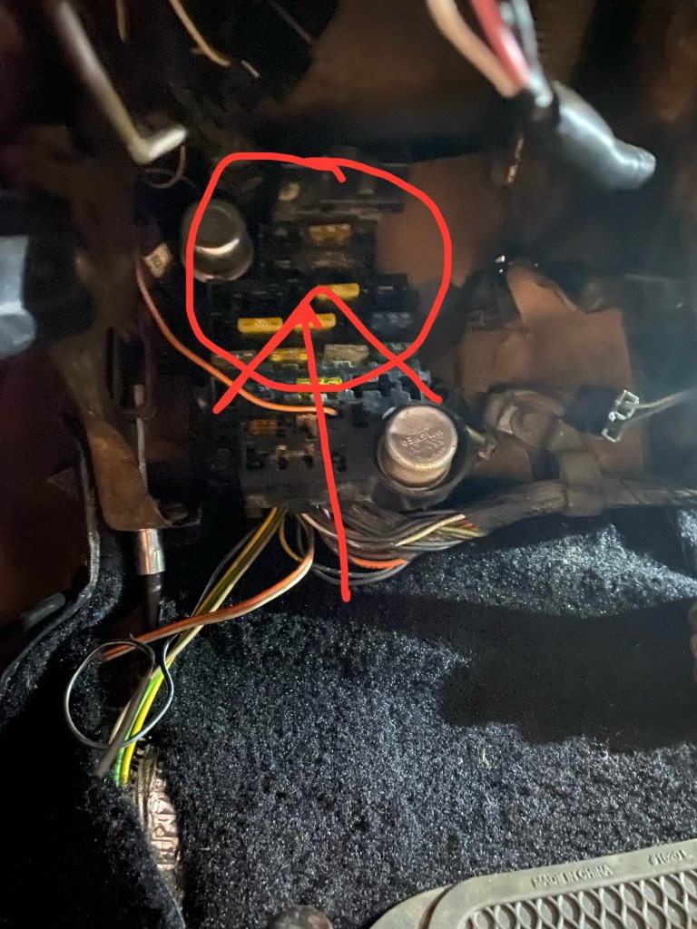

one fuse in the upper left half of the fuse panel but I have no idea what it does cuz the panel isn’t marked anymore.
Post a pic and we can probably tell you. Choke maybe??
RiverRat4
Mar 1, 2025
22
12
north coast ohio
r0d
vortec LS-2 5.3L
Ok here’s the fuse panel. What do these 4 fuses up here do? Im pulling each and seeing what shakes out. So far one out and nothing changes to interior

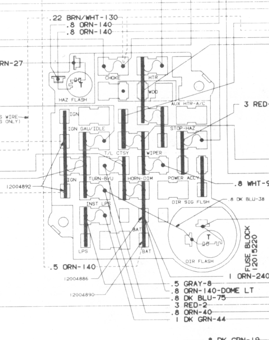

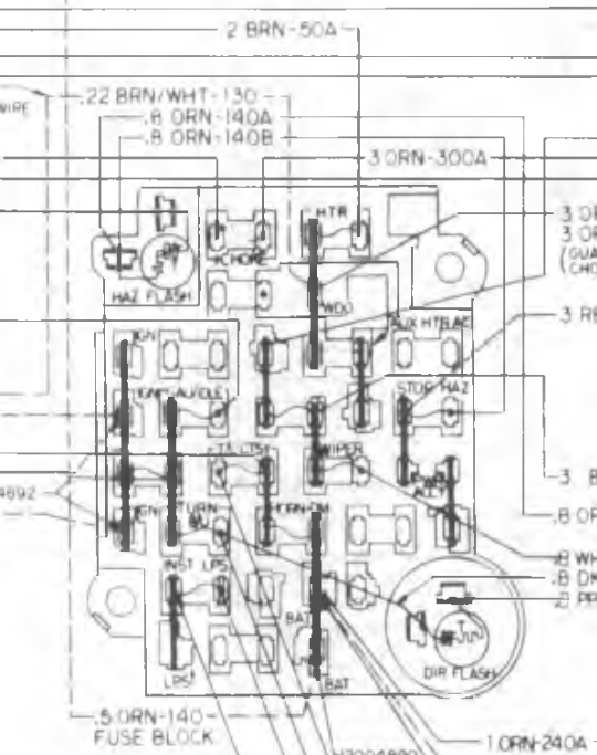

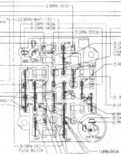

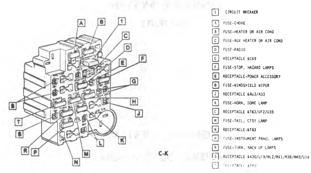

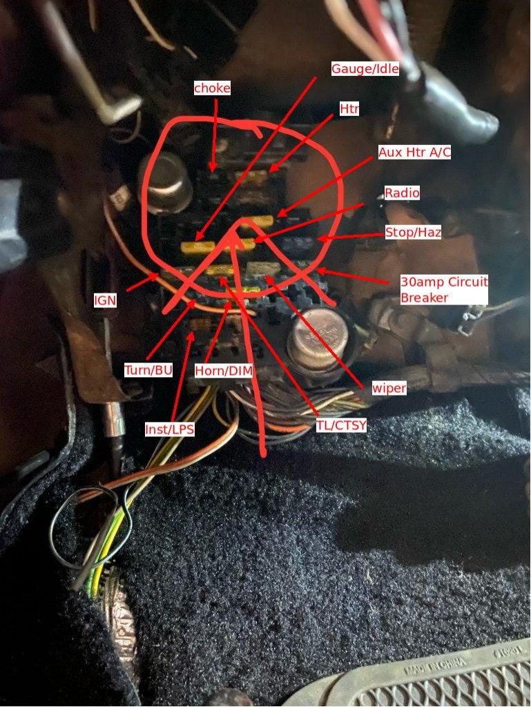

Jgonick
Jan 12, 2017
448
574
West Texas
Joel
I think I labeled yours correctly- double check with attached fuse block diagrams
only 81 diagram I could find was a little fuzzy-sorry- looks the same as the cleaner 84 though
