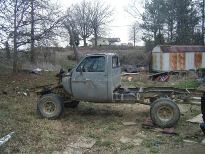

i think it will work but what do yall think 83 air controls and gauges with 79 dash and door panels with 83 doors

Door panels may be a little different, and the dash pad is made a little different but attaches the same. Otherwise everything should be really similar. You may run into some wiring issues if you use the 83 instrument cluster with the 79 harness. May have to move some of the wires around in the connector.

i have tracted down the problems im going too use the 83 hardness but im goin back with the 79 single headlights front clip and cut the head light hardness and make then work because im goin full power window and locks
the cab i bought is a 83 its complete wires doors glass everything
