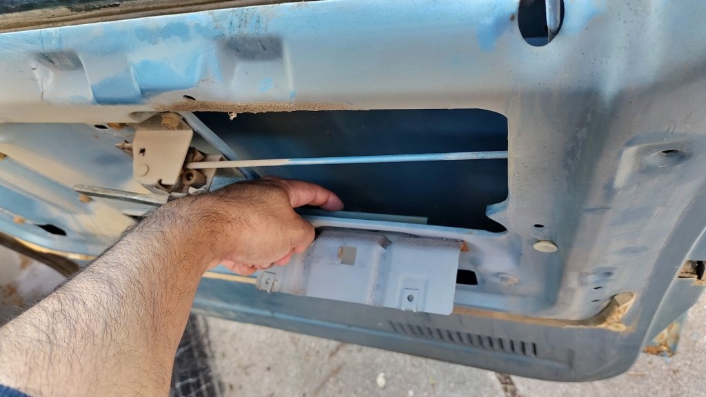

I have been looking all over, and cant find this part, its the lower channel that goes behind the arm rest
I rolled down the window and the window fell off the rear channel, pulled apart the door and saw it was missing the channel
its the one I am pointing to in the picture attached, but I need the driver side
Thanks!

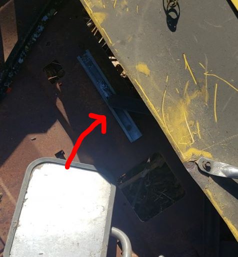

I think thats the guy right there, is it about 6-8inches long? right behind where the arm rest mounts?

oh the thing the actuator slots in and moves ? i see what you mean now. if not there, nothing is holding the thing in the proper spot and i presume that is what the glass has to be up against or whatever how it works.
Does it bolt off or should I grab the drill and the step bit and rivet time

Yep, the one on my driver side is completely gone, not sure what happened, maybe they tried to force the window down and sheared the spot welds?
Nah this thing is spot or plug welded to the inner door skin
yeah drill time haha
