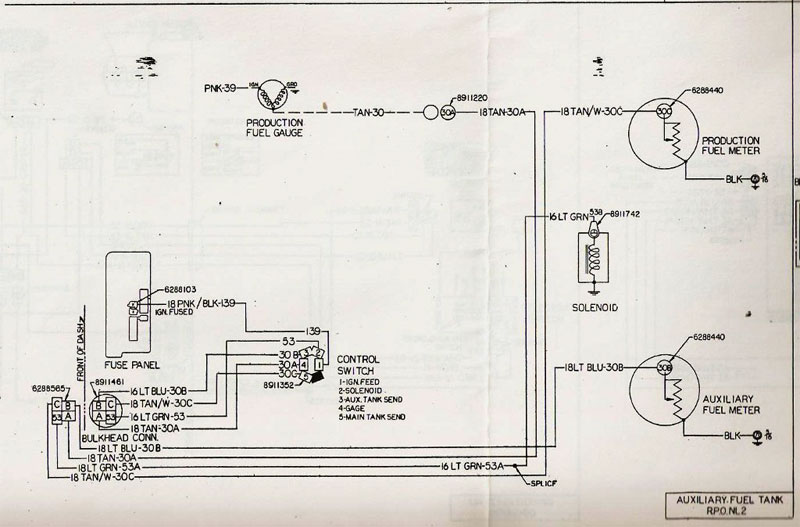

R8rPhan
Feb 5, 2017
452
42
California
Mark
1973 (1979?)
C10 long bed (Frankenstein truck)
307
Found this for a 77!
