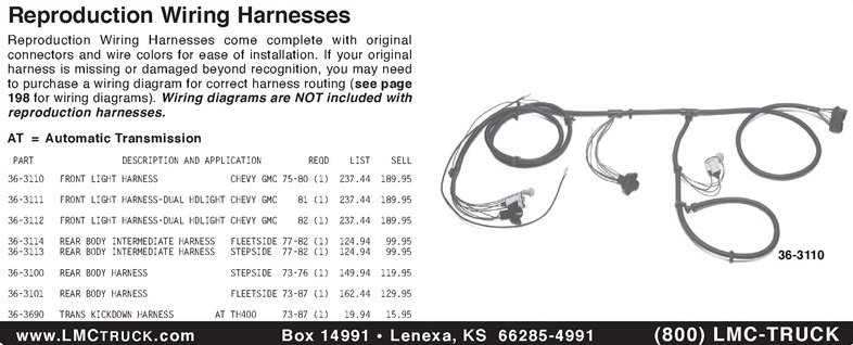

I have brake lights but no tail lights or reverse lights. Started checking wires and found that the wires were ripped out of the plug where the tail light harness plugs into the rest of the main harness run down the frame. So basicly i need the plug and maybe 6 inches of wire atleast or would love the whole plug and harness where it y's out to the lights. Whats my options, can this be bought somewhere or do i need to find one off another truck?

36-3101

Yowza thats up there in price and it actually looks from the picture to be more harness than what im needing.
Thank you for finding that though

you can buy just the pigtails for tail lights, reverse, license plate.. and make your own with wire if you want.
one is plug and play.. the other is more work.
I needed the intermediate body part but they don't have it for my year..so I had to repair my melted wiring myself.
Where did you find the pigtail? I could go with just that. I was trying to find it but wasnt so lucky
Thought about making my own but was unsure. Coming from along the frame to the back its 4 wires, from the y'd plug on back its five wires. Wasnt sure what the deal was

page 195 of the catalog for 73-87 pickups
