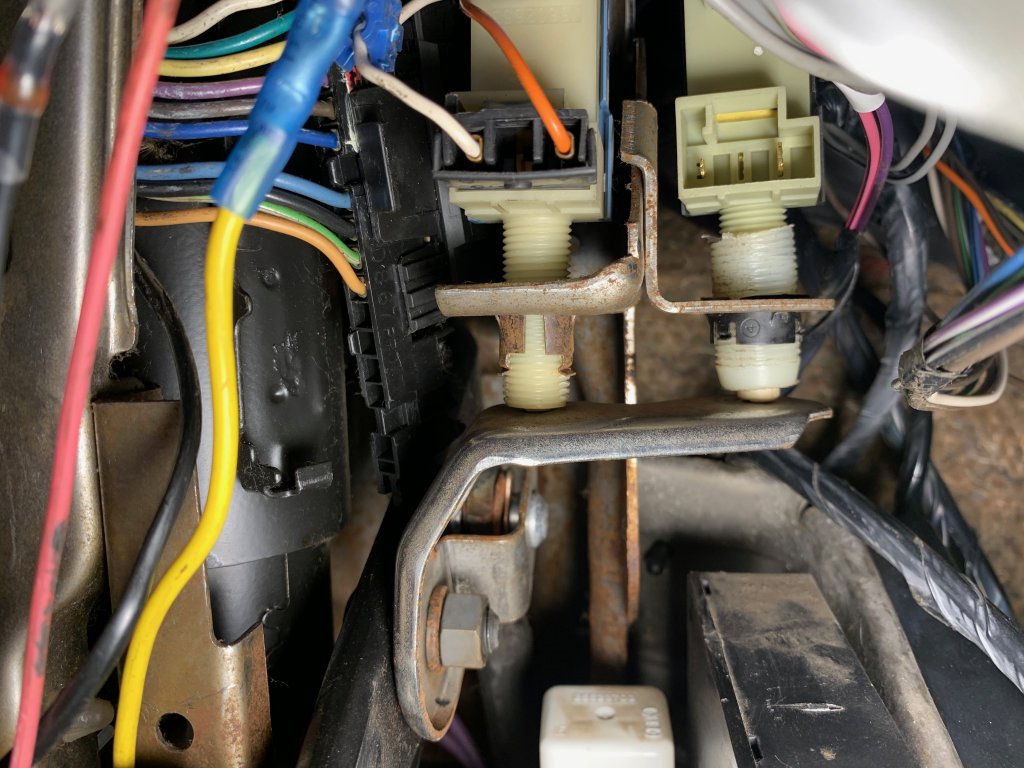

The one on the bottom of the pic is the regular brake switch. Normally open, triggers the brake lights and cruise cancel when closed, i.e. when pedal is pushed. This is what comes up when you search for a "brake light switch" on RockAuto or a parts store. The one on the top of the pic, though, is normally closed and when opened, it tells the computer that the brakes have been applied. The guts of this switch on mine are gone and the two wires (pink - ignition hot lead; and purple - goes to terminal on computer) are jumpered together. So the PCM thinks the brakes are never applied. It doesn't seem to cause any problems this way, but I think it affects how the torque converter lockup is disengaged. I just want it to work as designed so I need to replace the switch, but I don't know where to get it or even what it's called. Anyone know what that switch is called?

Correct. Torque converter switch. Unlocks the converter at lockup speeds, when the brakes are applied.

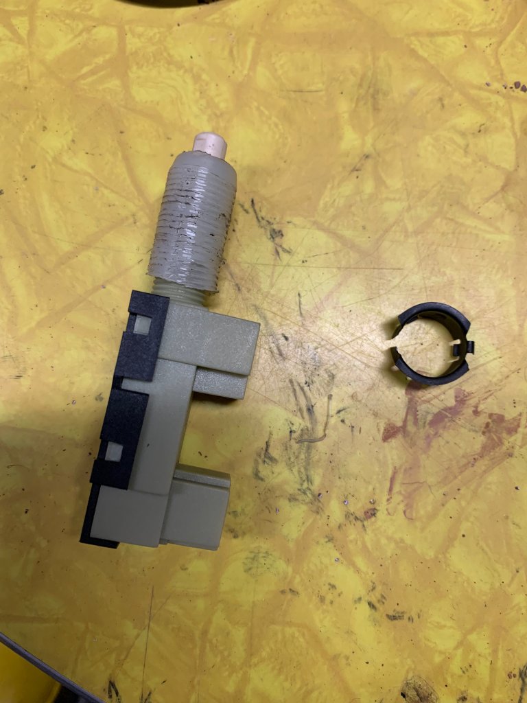

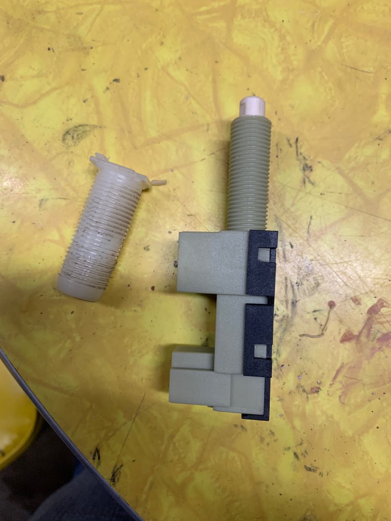

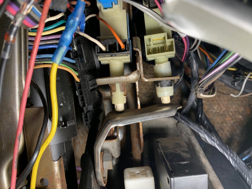

Thanks for all the input. I solved my problem. I actually had a regular, combo brake light/CC switch that I bought a few years ago before I realized there were two switches down there and it was the other one that was bad. I installed that extra switch in the location of the TCC/PCM switch and used the cruise socket to plug in my connector to the PCM (computer). I had to use the barrel of the old switch as a sleeve since of course they're different diameters. Works great, I have the ability to datalog through the ALDL port and the PCM now definitely sees when I push the brake pedal.
I'm glad I was able to adapt the other switch. I still am not able to find a TCC switch, ABS brake switch or anything other than the regular brake light switch (with or without cruise).
