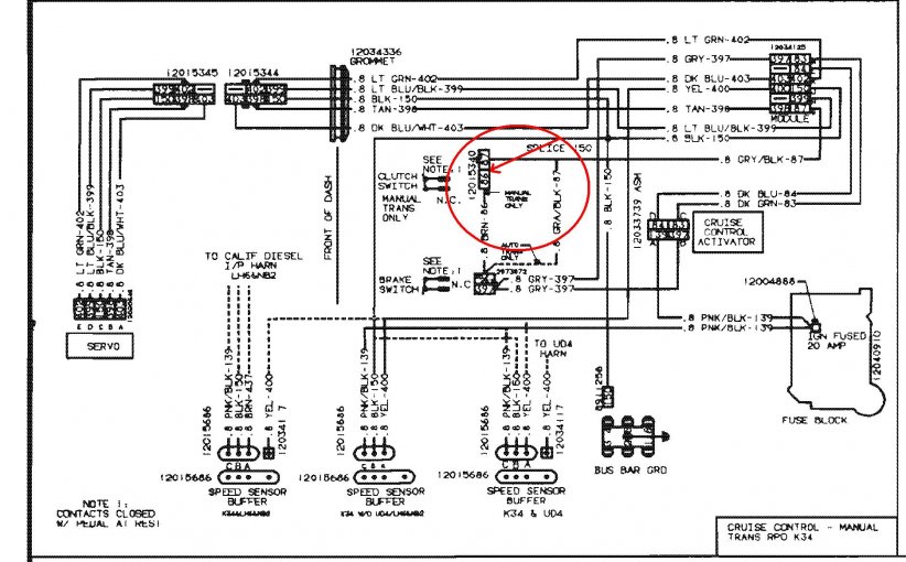

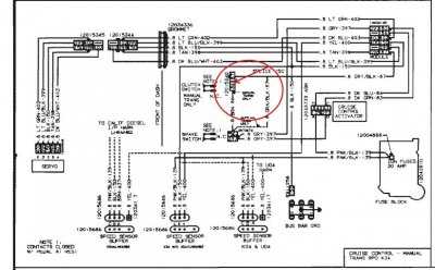

What is this connector for?

Has gray w/ black stipe and a brown wire. It is in with the cruise disconnect vacuum line and the 2 wires that go to the disconnect switch, maybe 12" short of the end of the hose.

That is the connection to the clutch disconnect switch - if you had a manual transmission it would cut out the cruise control when the clutch is depressed (like the brake cut out).

Thanks. I will just tape it up and zip tie it somewhere

It's not really an attachment - it is a link to an image sharing site. I'm surprised, turboimagehost is a highly respected and established host. Maybe I selected "adult content" instead of "family safe".
my computer finds you attachment infected..... what to do, what to do???
I suppose you could choose not to download it - just view it at the host's site. Or download/view it here
