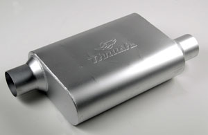

check out thrush welded mufflers i have them on my 71 c10 and my 90 jimmy
350 headers duel 2.5'' pipe dumped right past the rear axle on my 71 c10 deep throaty muscle car sound love them on it.
350 stock manifolds duel 2.5 pipe all the way to the rear bumper mellow at idle and normal driving but stomp on it and they come to life love them on it.
manifolds mellow the sound out alot headers sound more muscle car.
they are built like a flowmaster 40 series and sound similar but are half the price of flowmasters i paid 30 bucks a peice for the thrush welded mufflers.
i have flowmaster 40 series on my 84 jimmy 454 headers 2.5 pipe to rear bumper good rumble kinda loud but in a good way. love them on it.
and i plan to run flowmaste 40 series on my crew cab 383 headers with 2.5'' pipe dumped after the rear axle.
