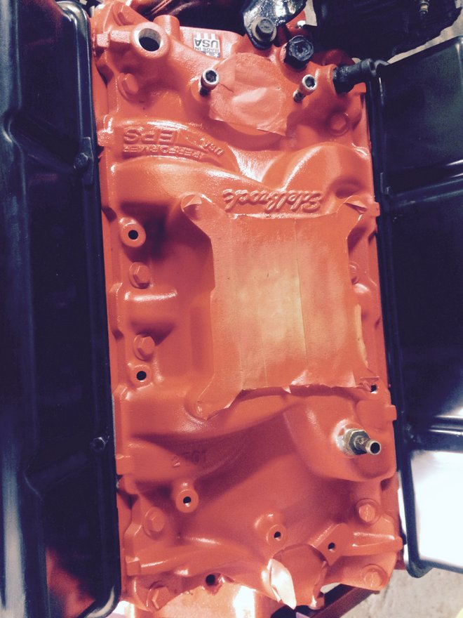

I dont have an edlebrock intake, but I can say that on my stock manifold the oil pressure line is at the very back of the manifold near the coil/distributor.The hole next to the thermostat spot is just an alternative location for you temp sensor, not sure about small blocks but early big blocks used a manifold sensor and didn't have a spot in the heads for one. It's handy if you want to use a fan controller or some self learning EFI without messing with your gauge sensor. Otherwise just get an NPT pipe plug. Now the two holes next to the carb are for the AC mounting bracket, I imagine this is specific to some years but regardless you don't need to worry about plugging them. I believe the back hole is a provision for an oil pressure sending unit, if you are going to mount your sensor somewhere else plug it (also NPT). Now I haven't done too much with sbcs (all my experience is bbc) so take what i say with a grain of salt, someone else will probably chime in to confirm or deny.
the one right behind the crab is a vacuum port to brakes if you need it
as usual, learn something new every day. Never see a brake booster hooked up to anything but the carb. Thx
That port was used mainly for the modulator on the tranny, then used for smog garbage and whatever else that can use straight manifold vacuum, so it can be used for a vacuum gauge for sure, just need to add a fitting.I guess that spot would also work perfect for a vacuum gauge then, huh?
Never seen one hooked up there either, but it surely could though..as usual, learn something new every day. Never see a brake booster hooked up to anything but the carb. Thx
Keep stacking 3-way and 4-ways til it pops outta the hood? HahahaYep it would, that port can be used for anything that needs manifold vacuum, just make a tree, lol..
keep stacking 3-way and 4-ways til it pops outta the hood? Hahaha
