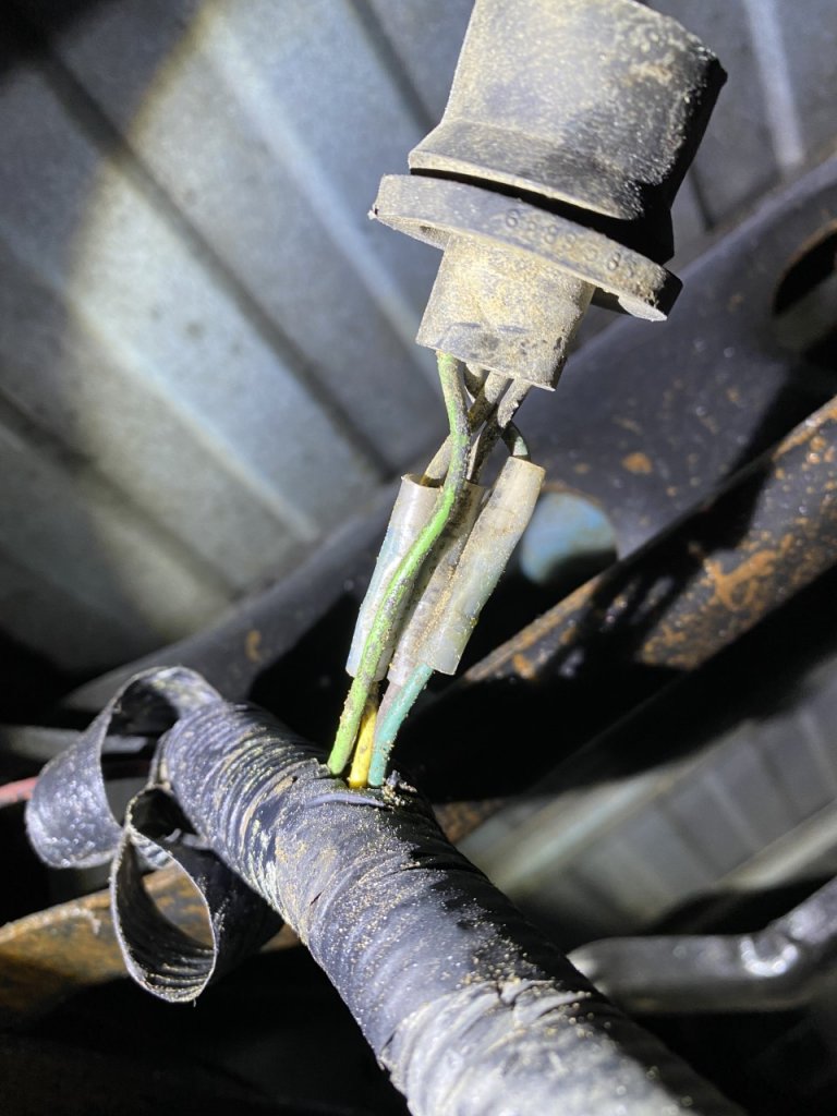

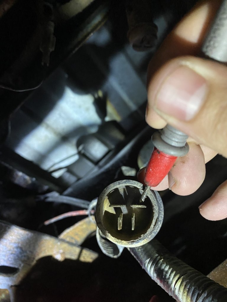

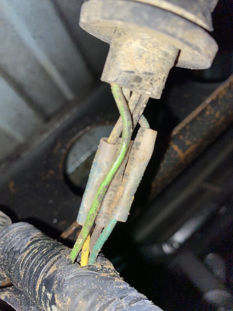

Looks like the tails have been spliced into. I have a all steel tow bumper and some setup that I'm not familiar with.
I have 12v to the single prong on the rubber grommet. I cant tell which wire the prong is associated with. Should I be getting 12v to any other prong?
PO made a mess of the wiring in the cab so I am sure itll be fun to track down.
next step is to test the wires at the column correct?

Yours is an 84 but here is a wiring diagram for my 85. Looks like the wiring is the same color.

Push and pull the hazard switch button several times. That sometimes gets taillights working again. If not, read on.
Get a cheap 12 volt test light. Check for power at the yellow wire (left turn) and green wire (right turn) of the turn signal switch at the base of the steering column. If the light flashes with the turn signal, the problem isn’t the switch.
Find the green and yellow wires at the firewall electrical (near the brake booster) connector. There will be a dark green (right turn) light green (reverse) brown (taillights) tan (fuel gauge) yellow (left turn) check for power on each wire while operating the circuit in question. Keep working your way back, eventually you will find the break in the wires.
