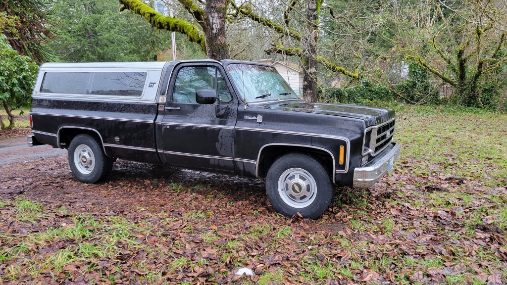

I recently purchased a 1978 C20 Camper Special (2wD) with the 454, and she needs some things. One of those things, is new tires, and so perfect opportunity for new wheels.
I've been "doing the math" and a lot of reading about what fits, but much of the calculation depends on what is on there now. I know the tire is a 9.5 R16.5 - which is basically equivalent in height and width to a 235/80/16 (Radius 30.6, width 9.5 vs 30.8 and 9.3) So I've been using the 253/80/16 as my baseline. When measuring for clearance changes, I need to know if the stock 16.5 wheel is 6" or 6.5", and does it have 4" backspace? I've read posts from several sites that conflict - some say its a 6" rim, others 6.5 and other sites suggest 7". Backspacing is suggested at 4" , but again, conflicting data.
I could go pull a wheel off, but that requires going outside....and well....its cold out there, plus its dark. Who knows what's lurking around. Does anyone have a definitive stock wheel width and backspace for the 1978 C20 16.5 rim?
Thanks - and although you've clearly seen one before, the obligatory picture of the truck:

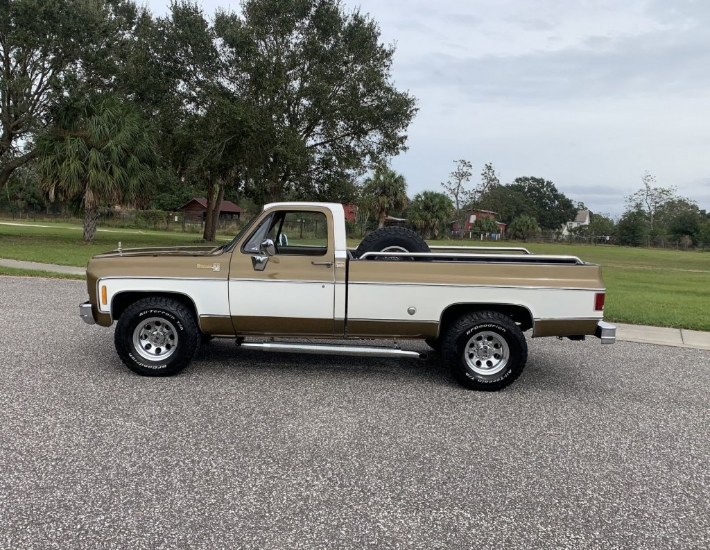

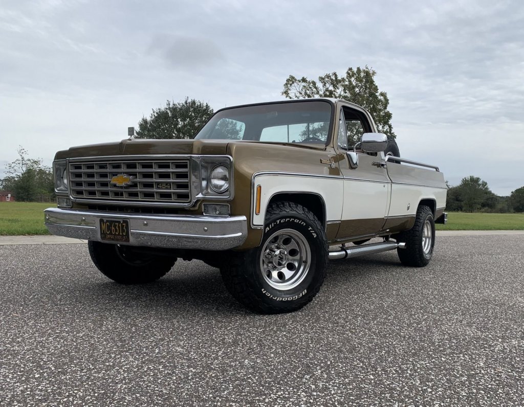

As far as what I want to run - ( and this is all for show - this is a 2WD and the only "terrain" its likely to see is either black top or the back field of my property) - but, ideally I'd like to see 285/75/16 on a 8"rim, with 4.25 backspace. According to "the math" and comparing the stock specification (granted I assumed a 6.5 inch rim, so I'll re-run everything at 6.75) they should fit. Ive also seen a few examples of this tire on a 2WD, but unfortunately never with an owner that can tell you anything about the fit. That being the case, I've been considering the same tire but in a 265/75/16 - that seems like a more commonly fitted size.
This is the truck that got me thinking about the 285/75/16 - according to the add material its running 16" wheels with 305/70R16 BF Goodrich All Terrain T/A Tires. It doesn't say anything about a lift and I don't see evidence of a lift kit in the chassis pictures. Its a '74 C20 Camper special 454 2WD, so other than year, same truck as I have.
