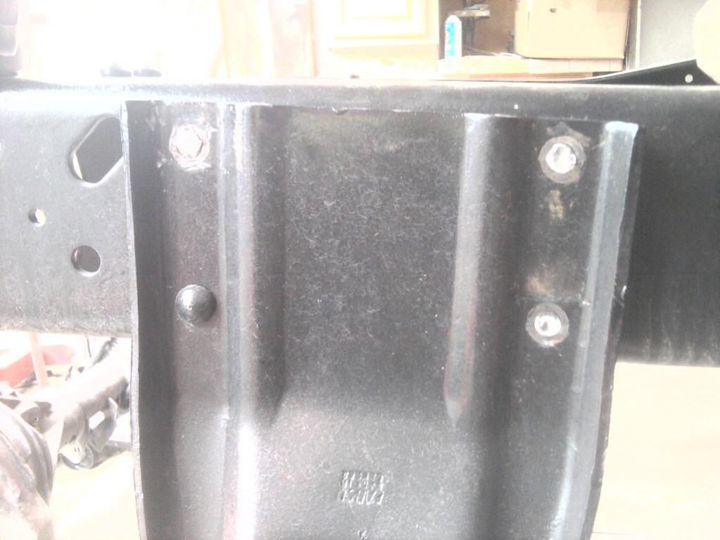

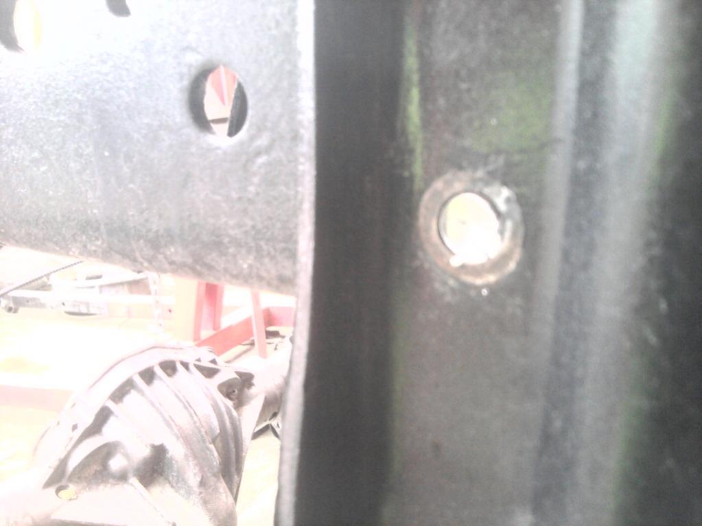

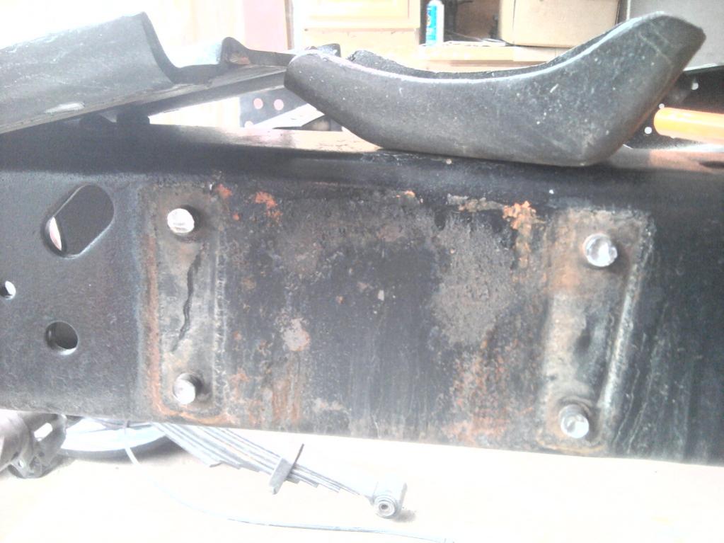

use a small punch to make a divit in the rivit then drill it to the frame with a small drill bit (starter hole) then drill it with a bigger bit 3/8ths or 1/2 inch to the frame.
if it does not come off you can knock it off with a chisel and a hammer or this method makes using an air chisel alot easier and faster
then the stub sticking out of the frame needs ground down flush to the frame then they knock out easy if not ground down they mushroom out
