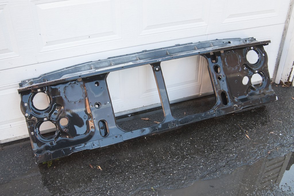

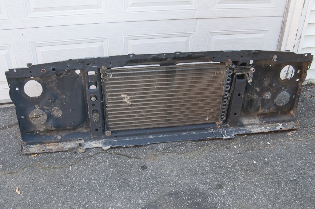

Instead of buying a new radiator support, could I just cut bigger holes for the lower lights? It seems much simpler to do that than replace the front end.

I wouldn't because the mounting won't be compatible. The single headlight core support has this larger oval in the bottom row. The dual headlight core support has a smaller circle. You might be able to fab a square metal plate and cut a hole in the middle that corresponds to the size of the dual light core of you have a frame of reference, but just get one off a junker in one of your local salvage yards.

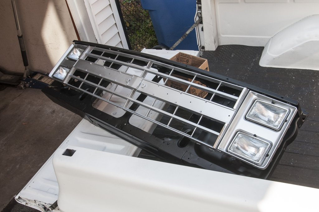

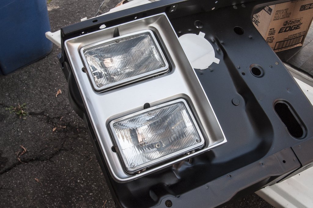

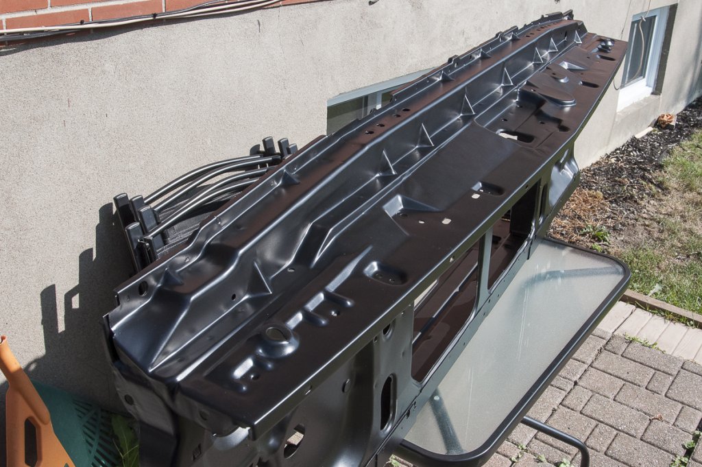

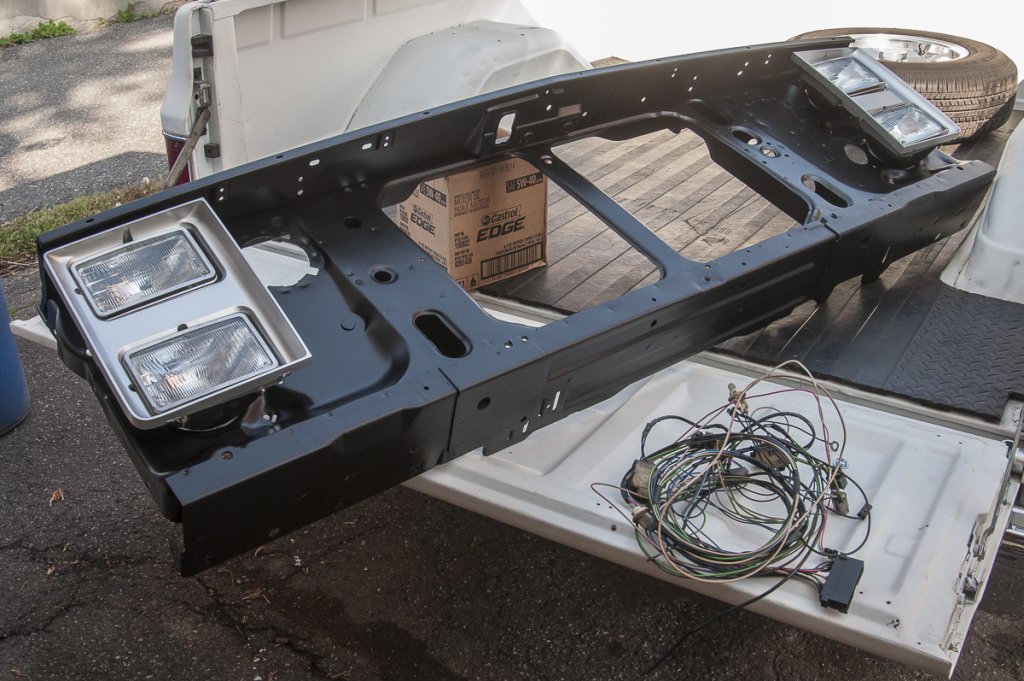

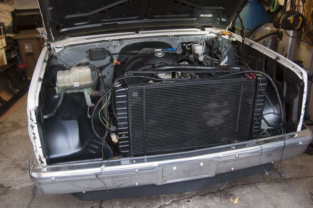

bring an old topic up! gonna do the dual light swap on mine! :)
First: found a rad dual core in good condition....and i'm lucky to have found one! $200

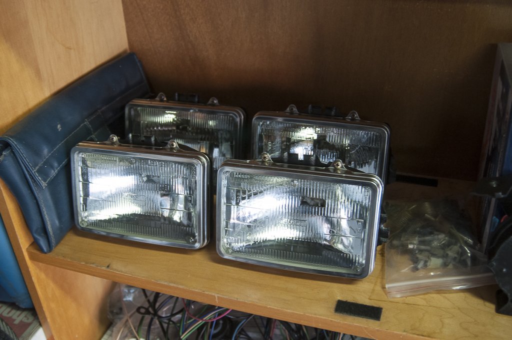

2- found all the part you need: 4 headlight kit with all the trim nut and bolt, 2- light bezel and all the complet wiring $60
allready got the Silverado grill on my truck so no need for that (and got a brand new gril in spare in case)

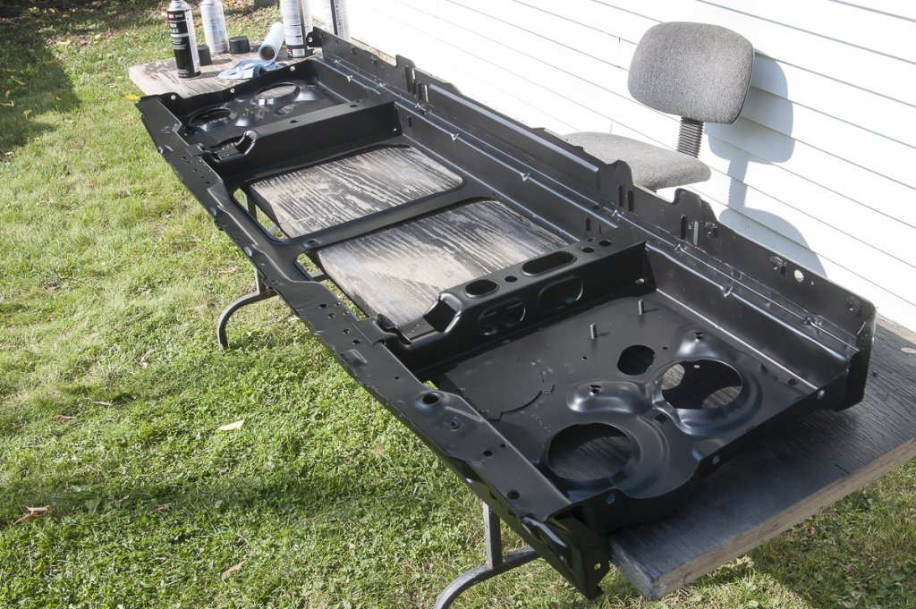

:D

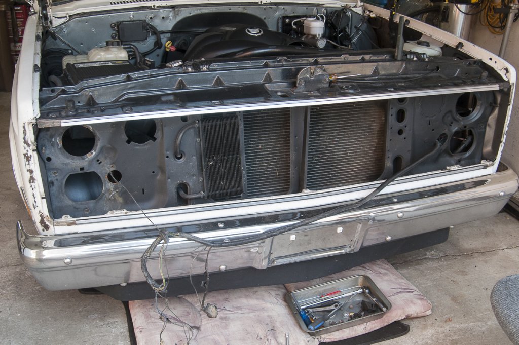

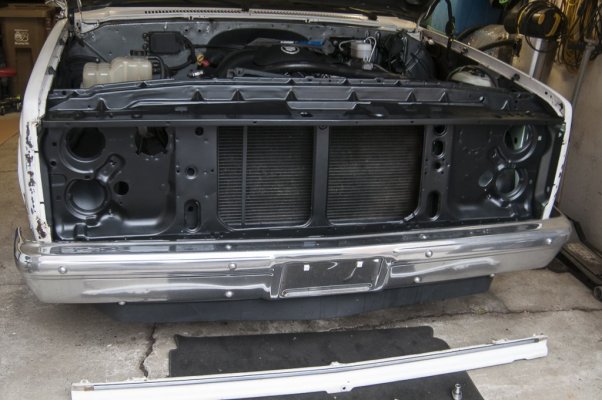

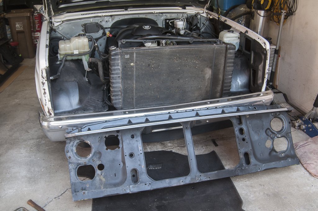

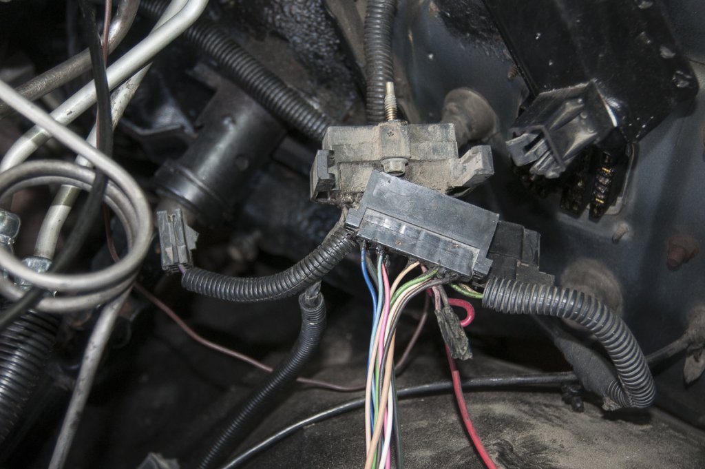

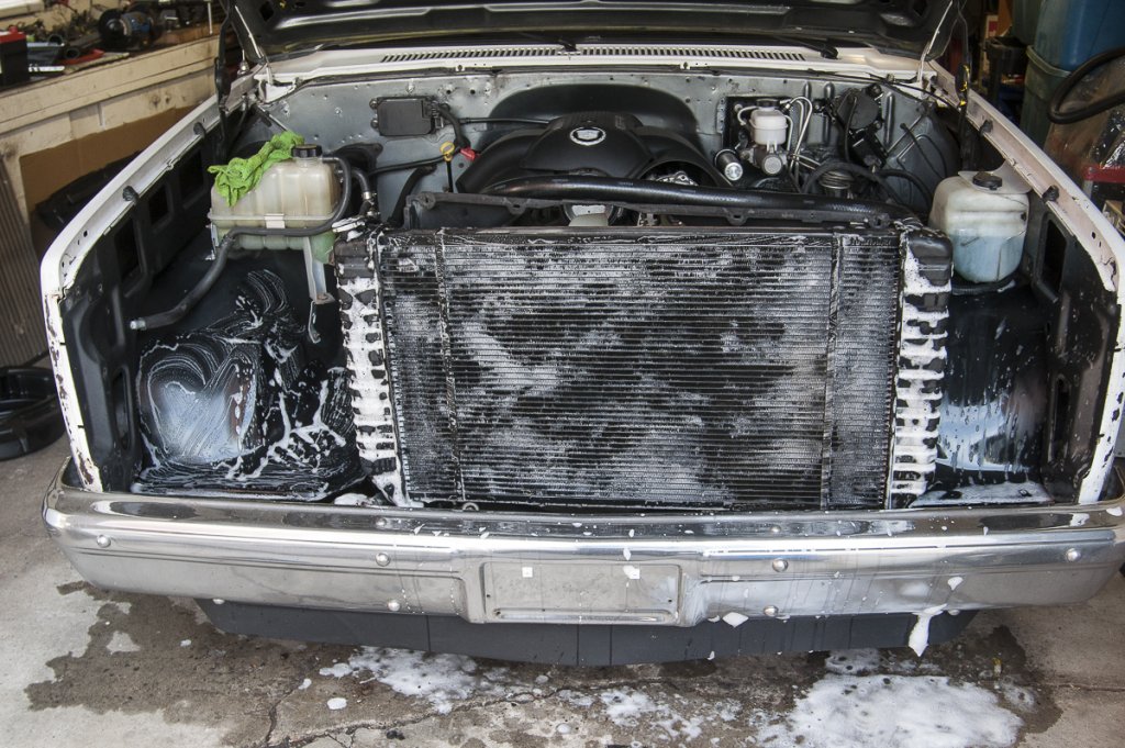

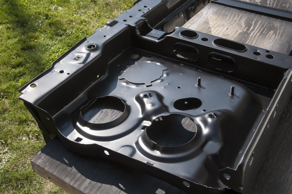

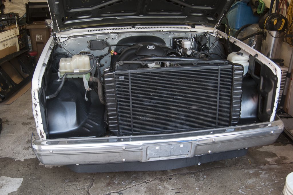

starting swap today! :)
TPISly-C10
Apr 1, 2019
615
878
Boucherville QC Canada
Sly
C-10 shortbox
LQ4 6.0L

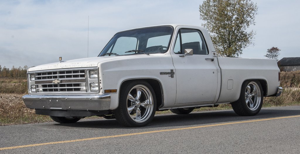

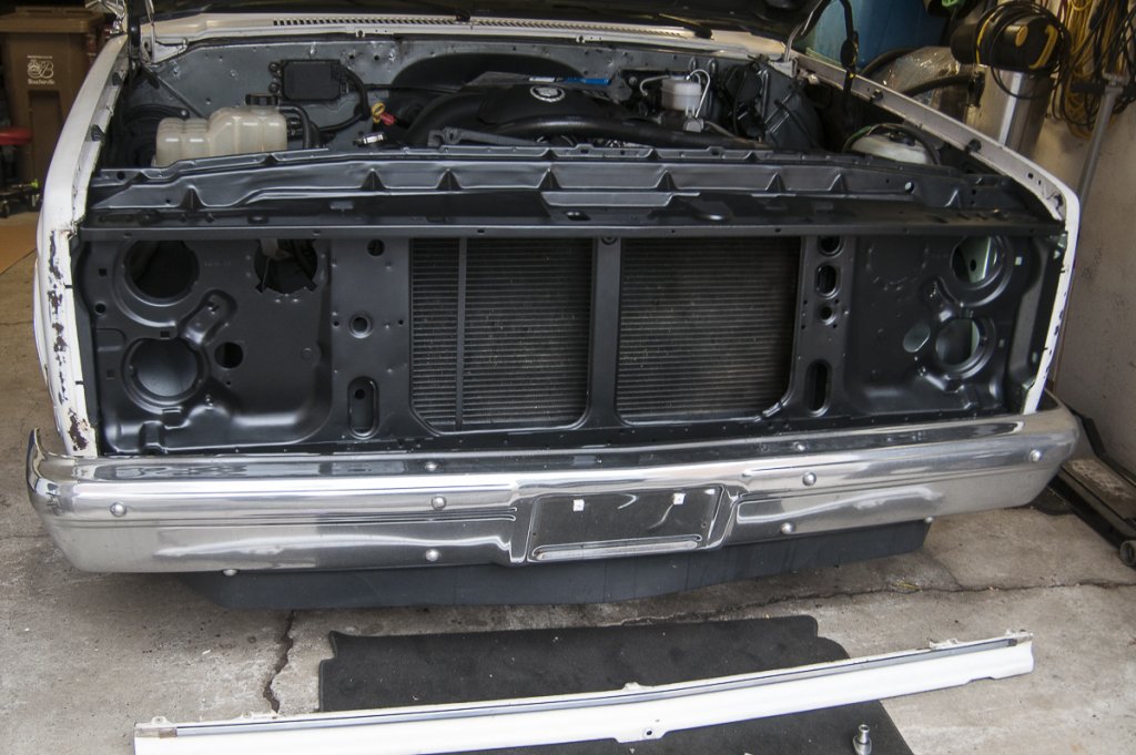

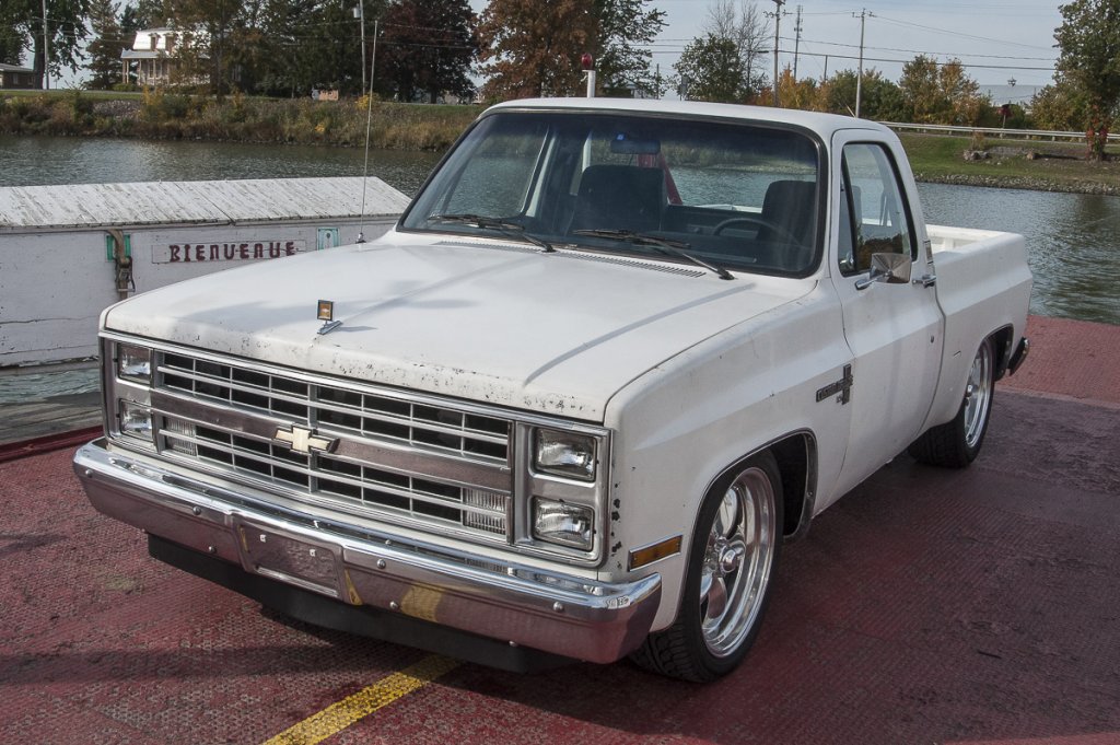

job done! :)
