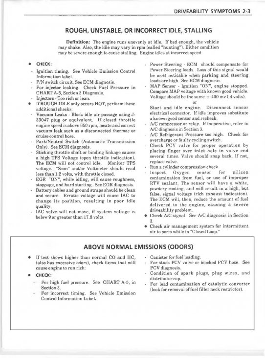

  • Pages from X8736_1987_GMC_Light_Duty_Truck_Fuel_and_Emissions_Including_Driveability[1].jpg
DuallyGuy
Aug 17, 2012
63
San Fernando Valley, California
Matt
GMC C15 1/2 Ton Stepside
5.7L 4BBL 350 V8
Thanks for that info and for the paperwork. According to that page, I have noticed that my truck idles high when it gets hot. Not too high but def higher than it should. I've searched high and low for a vac leak. Maybe I just don't know how to check. The fuel injectors seem to spray just fine. I just inspected them last weekend. I wish you guys were my neighbors. LOL Come over and check out my truck.
