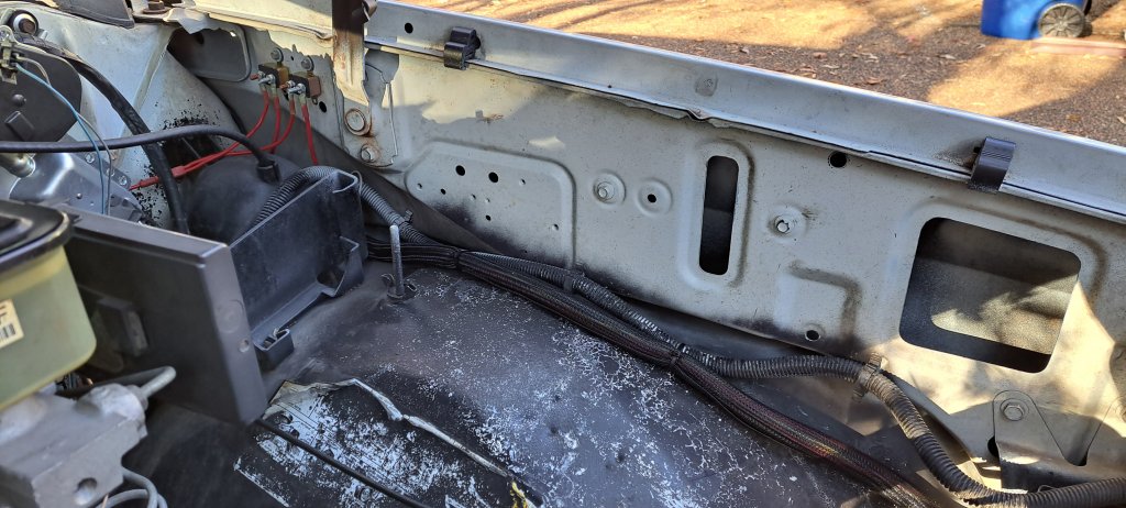

Here's what the inner fender looks like. I've even poked around in those cavities with an endoscope - the only wires inside the fender are the ones that go to the side marker.
Thanks. I don't see anything, but the existing factory loom, maybe it's worth while to see if it's tuck into it there. Look under the brake master to for it being tucked up in there.
If you cannot find the wiring at all you will have to decide if you want to try to wire the new pump into the existing switch or hook the pump to a separate independent switch.
Rob, you win the prize! I just went digging into that loom, assuming there were only wires to the lights in there, and *bingo* - one pink wire, and one white wire, just hanging out in there. I plugged those into the washer pump and all was right with the world. The pump now works with the switch, just like it should. The only downside is that I feel like a pretty big doofus for missing that obvious solution. Funny how often these things are a lot less difficult that you (okay, *I*) think.
For anyone else looking at this thread, the two you want are the pink (pos) and white (neg) wires that come out of the firewall and head up towards the headlights. Since the washer and the wiper motors share the same fuse (#16), I had it in my head that the wires would be all together. Silly me.
