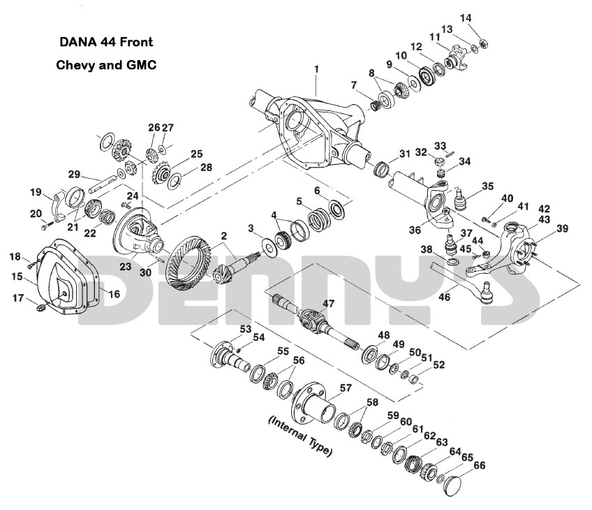

Ok gang, what am I missing? This diagram shows the pinion depth shim stack in between the inner bearing race and the diff housing, not between the bearing and the pinion gear. Which means I'd have to remove the race from the housing every time. I suppose a set up race could be made as well. It appears based on this feedback that you all are putting the shims behind the inner bearing and the pinion gear. It would accomplish the same thing in terms of setting pinion depth....I think. Newbie challenges here!

If the pinion depth shim goes under the inner race that’s ideal. Just carefully tap the race out to make adjustments. Only common risk there is damaging or bending your shims if you don’t pay attention. No specialty tools required, just a hammer and punch. If the shims are shiny and hard to see agains the shiny bearing race mark them up with a sharpie so you can see where they’re at when placing the punch down in there.
I’ve never built an older Dana 44 only a late model one. IIRC the pinion shims were under the race on that set up too.

I'm going to have to get a setup race. Or I need to remove some material from the housing where the race seats. I had a heckuva time getting my new race seated and removed. Damn near destroyed a new brass drift.

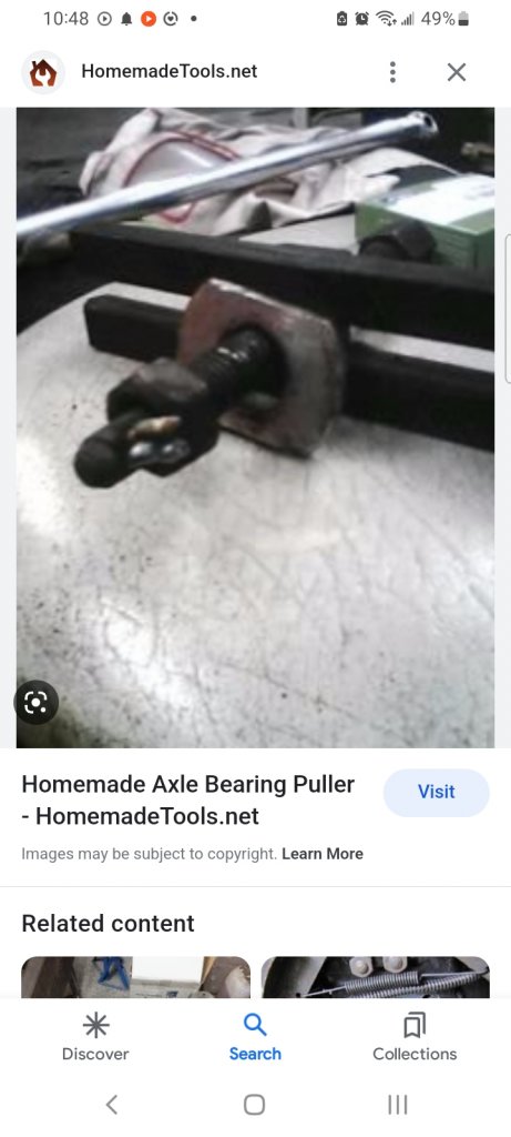

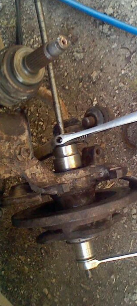

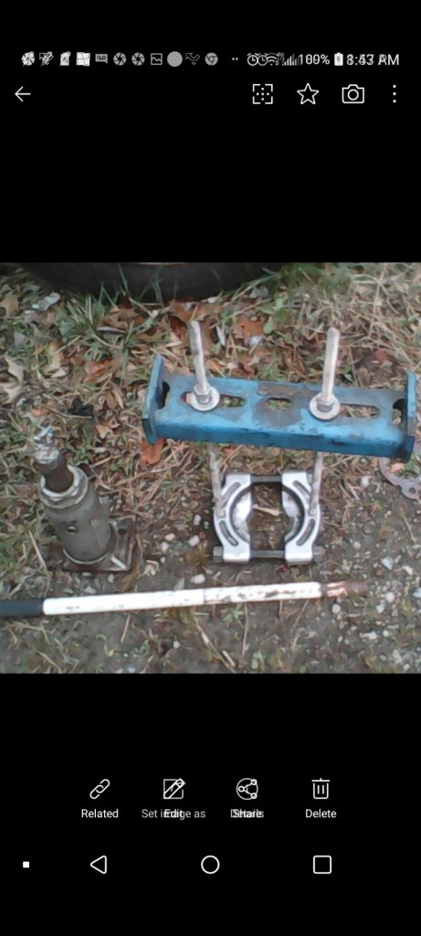

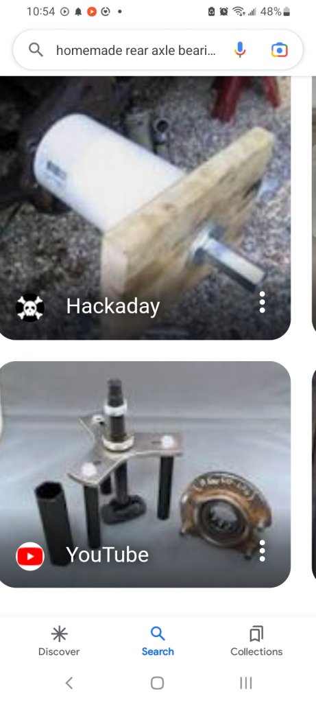

I haven't worked on your exact setup and don't have a pic or even no where I put the tool I made to pull the races when I was done with it 15 years ago. I did find something to use as a description picture, get a piece of heavy strap,drill a hole in the center and round the corners,don't weld the nut to the all thread You slip it behind the race and use a piece of all thread to pull it out. Or a slide hammer,you can pull it all back together with all thread 2 sockets 2 washers and 2 nuts.I pictured me pulling in from hub races with all thread. Look for an exploded view of your diff. Shims between the race and carrier doesn't sound right. I think your shims in the wrong place but I've never done a dana.
Me neither, lol, but that's what the diagram shows. Check that out on my earlier post. And since East Coast Gear (probably others too) make a set up race tells me that's where they are supposed to go.
