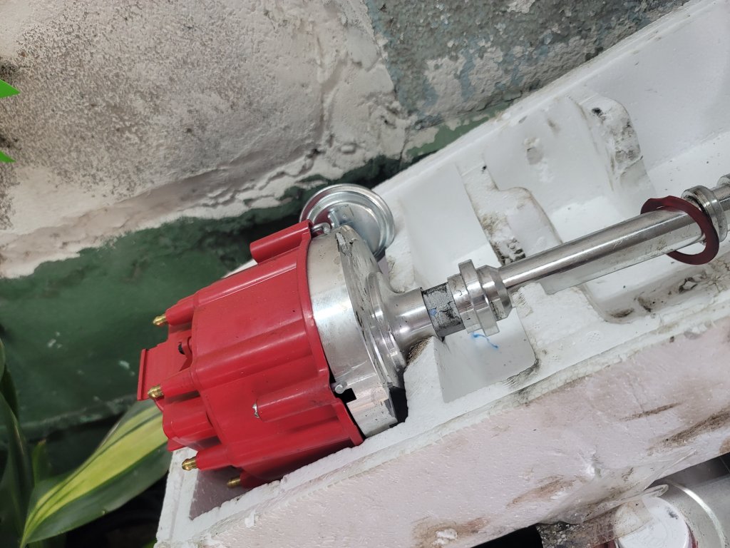

3,730
6,754
There is no spark controller with an HEI per se. The coil is in the cap. As long as the 3 wire plug is connected between the module and coil all you need is 12 volts from an ignition source. The other wire is the tach signal. If all that's correct and it still no sparky, I'd get a new module, verify voltage and let r rip.
Edit: make sure the source voltage is hot during cranking AND ignition on. Some ign circuits are bypassed during cranking. Easy to verify with a test light.

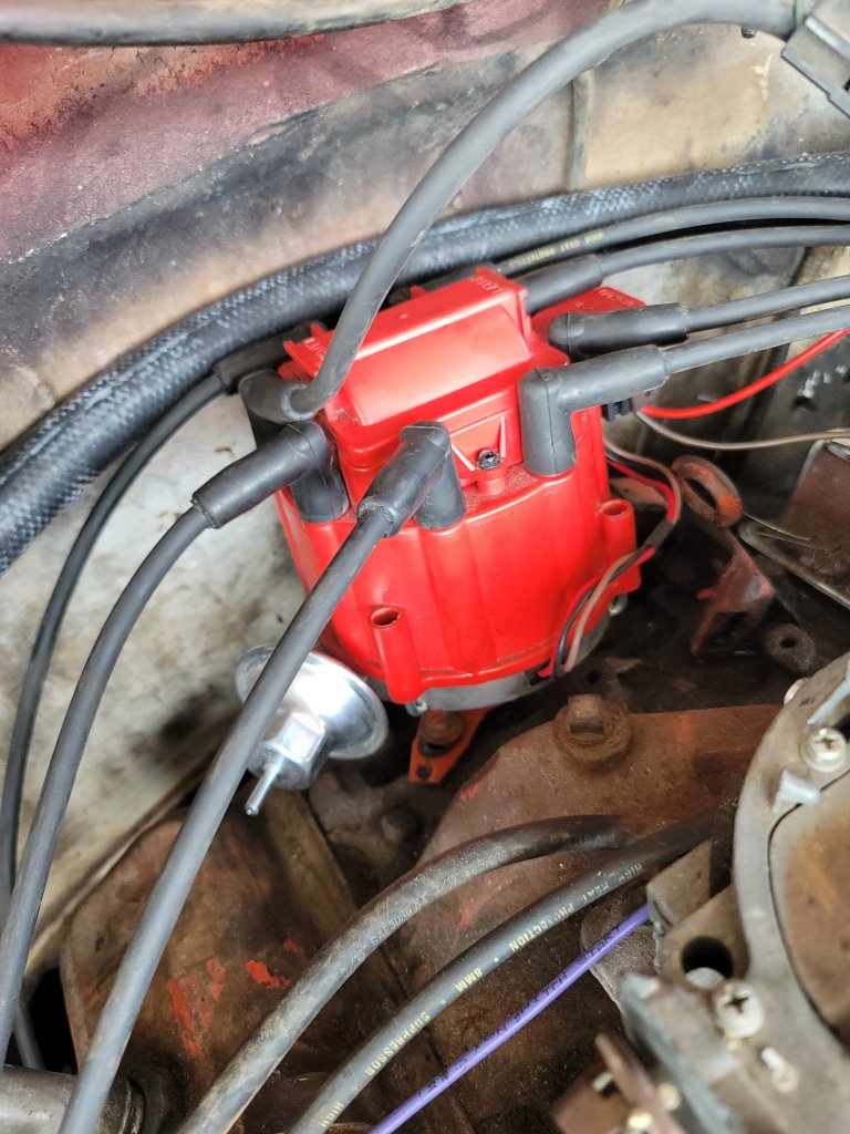

I put the new one on
ReefkoiC10

Im wondering why the plug wires on the right all go to the right bank and the left to the left, the firing order is off I’d guess….

Of the 5 wires that leave the cap and go toward the odd bank, 1 crosses back behind the carburetor and goes to the even side . From what is shown, it appears that the wires are going to the correct sides of the engine. Supasosa, you said that you put the new distributor in but didn't say whether or not that fixed your problem. If still no spark, tighten the distributor clamp enough to ensure ground, and check the pink wire at the distributor for power (best to check with a test lamp). Let us know.
