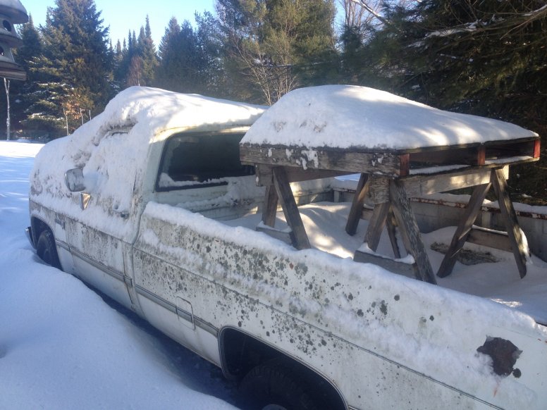

Greetings from Ontario Canada. Just picked up a 1987 GMC K 20 4x4. Going to start my restoration. Can't seem to find info on this topic?? I plan on rebuilding the 350 engine and would like to replace the current tbi with a Carb set up. Desired HP will be 350 to 375. Am I wise to go to Carb vs tbi? I'm kinda old school. When this truck came for sale I wasn't thrilled that it was a 1987 because I knew it was tbi.
Can someone please let me know if I should work with the tbi or swap it out for a 4v Carb? I will try and post pic's shortly
Thank you and have a wonderful day.
