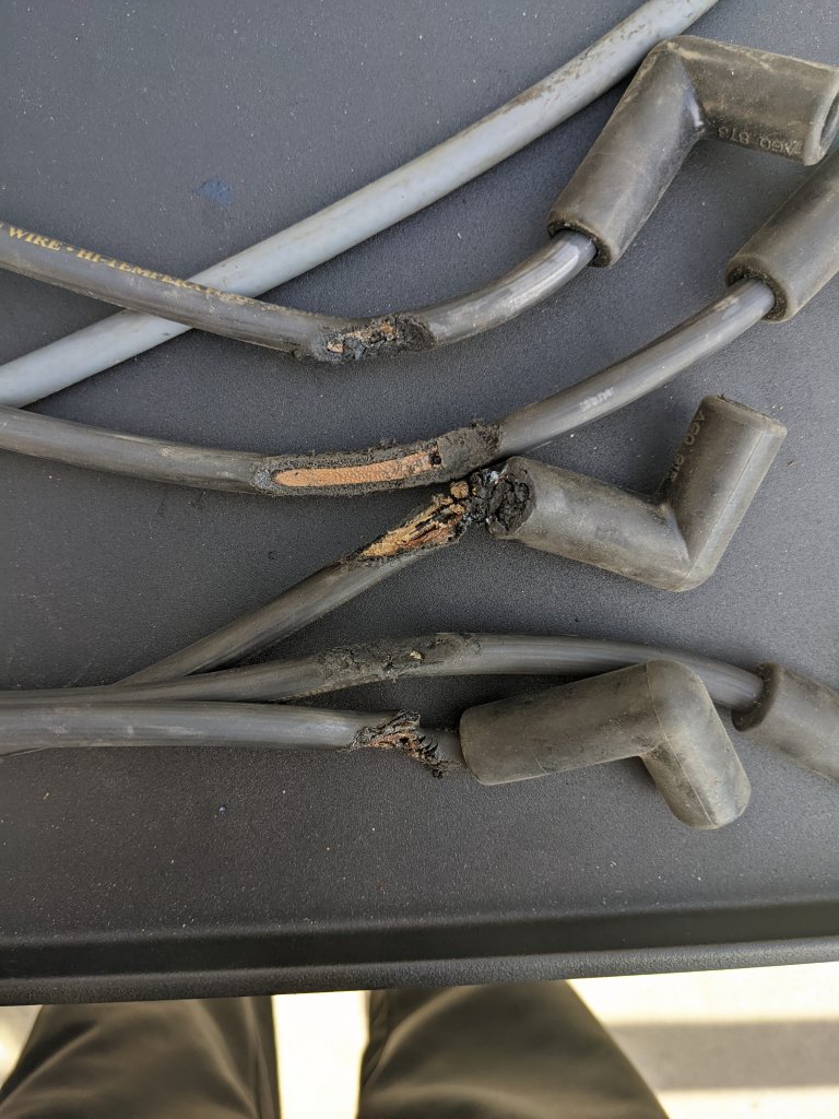

Well...mystery solved on why it wouldn't start up...it looks like in my haste I wasn't too concerned with where the plug wires were sitting on the exhaust manifold...it started right back up after I pieced in some of the old wires...
However now it's not wanting to start/idle and it seems like a fuel issue..I think the EFI ma be flooded at this point...I will let it dry out and try to get it going later...probably ordering a new set of plug wires wuld be a bad idea at at this point either..
