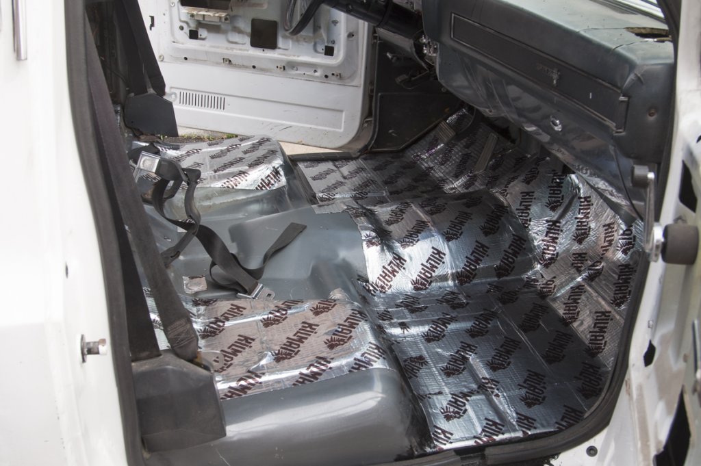

I can speak for heat suppression. Stuff works great. The trans tunnel gets extremely hot in any warm weather. I've only done the front floor pan yet but I did also notice a sound difference.
Then I did the dynaliner, their closed cell foam and that helped even more. The floor would be the hottest part of my truck in the summer, hotter than outside temps, felt like the heater was on. After all the insulation and just a vinyl floor mat the inside temps dramatically came down.

I did the entire cab floor, rear wall, door panel area and inside of the doors. Overkill? Maybe but it sure is quiet!!

Absolutely. Between the KilMat, some Noico closed cell foam and new seals, my truck is so much quieter going down the road. Well worth the investment. I believe I used 2 50sq ft boxes of Kilmat (went a little overboard lol. Did a double layer on the floor and back wall, single up the firewall as far as I could, single on the kick panels and B-pillars under the trim and a few pieces in each door). I then topped it with Noico RED 150mil and used 36sq ft of that. HIGHLY recommend.
