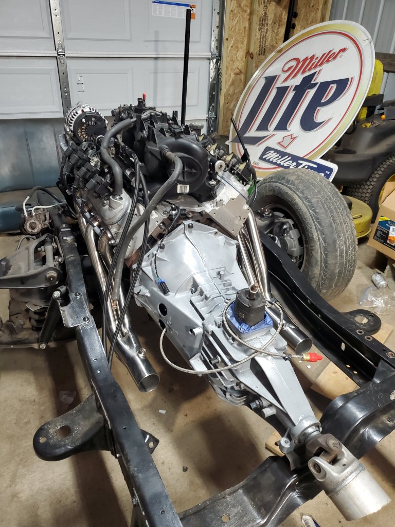

I have been down this road. First and foremost decide what you want Auto or manual. Don't worry about anyone else's opinion. There is a lot of aftermarket/fourm support for 4l60 or 4l80. Nv4500 is nice because of overdrive if you are planning a lot of highway driving. I went the less favorable opinion and went with a nv3500 from a 2003 silverado. Time will tell if it will hold up to the projected 375 - 400 hp/tq range. Nv3500 was a direct factory bolt up so I know it will work.

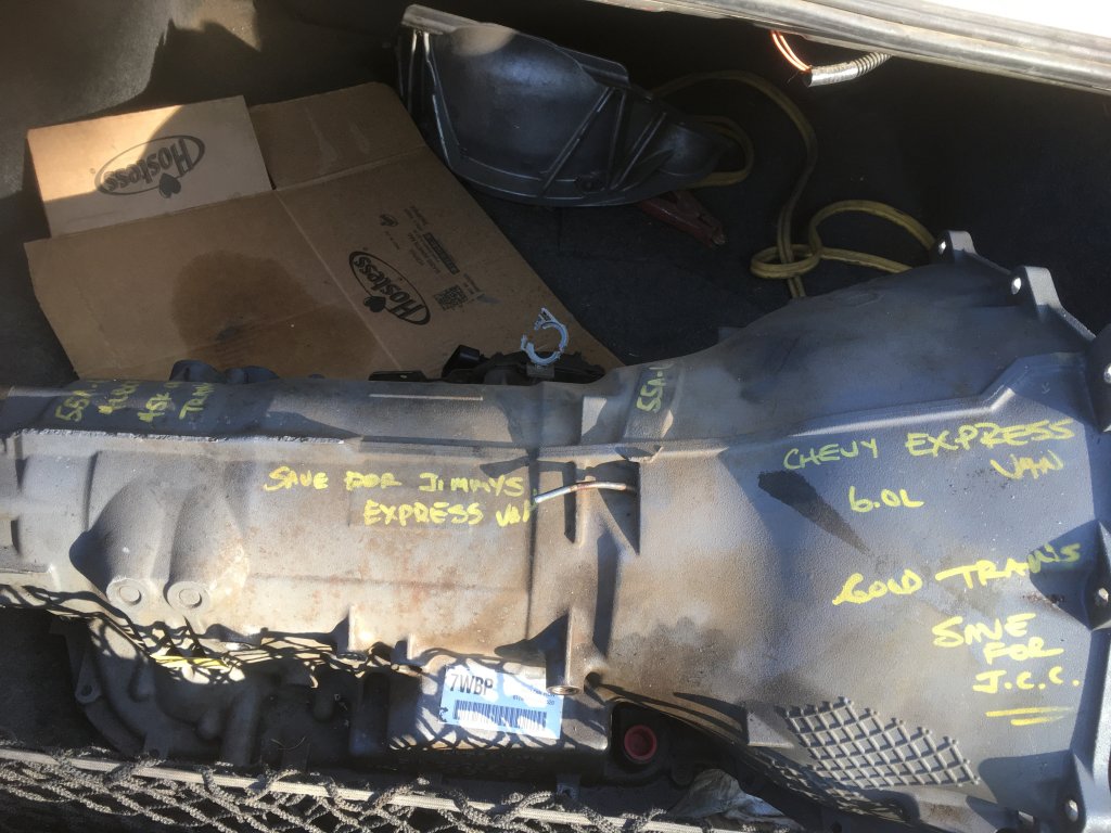

I have a 465 in the International 1600 loadster, rebuilt it a couple times, old tech, parts are getting scarce, no OD. I will build my 454 with a 4l80e, and 6.0 LQ4 which came with a 4l80e. I love to shift too, but not truck trans. Muncie, t5, t56, all ok, but will need pretty expensive parts to upgrade torque and big tires break transmissions. I like lightening fast shifts. So on this road for performance i will use the 4l80e. This one 45000 miles, 500 bucks.
